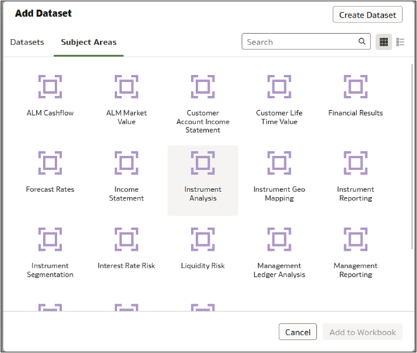

- Select the Subject Areas tab. You will find all
the relevant subject areas listed as follows.
Figure 8-18 Subject Areas

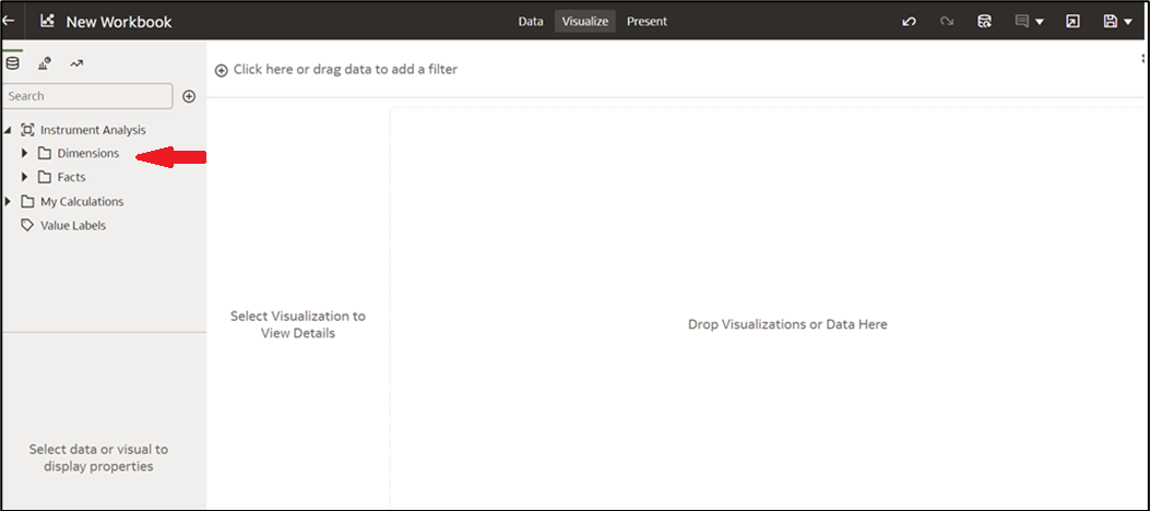

- You can double click to select a particular Subject Areas and a new
canvas will open up with the elements of the selected subject area.
Figure 8-19 New Workbook
- Expand the Dimensions and Facts and drop the relevant items on to the canvas. By default the best visualization/ chart type for the given data is displayed.
