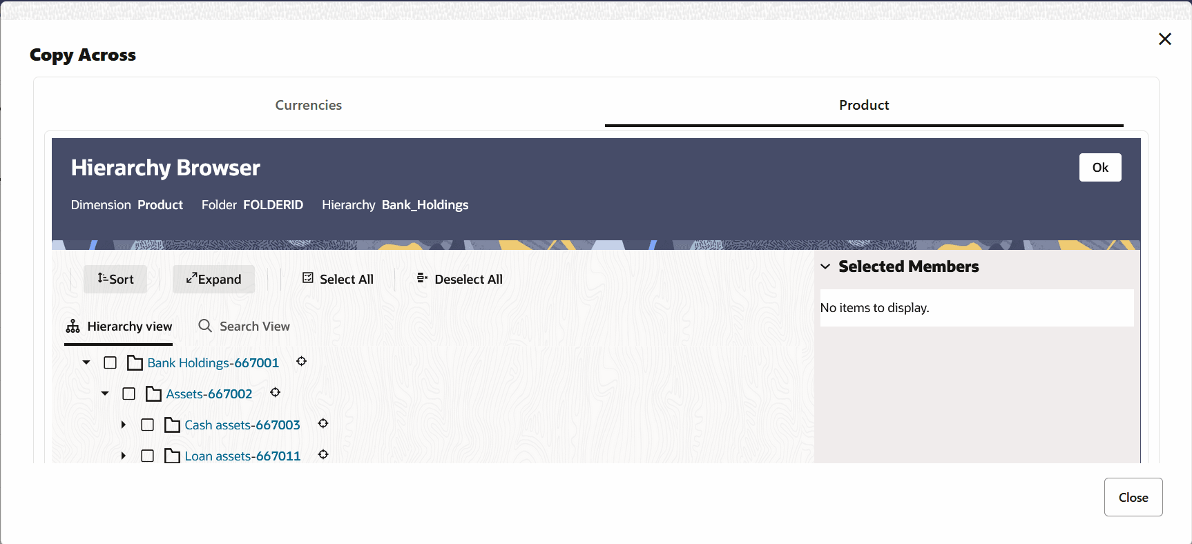

- On the Copy Across dialog, select the Product
tab. Select the relevant leaf from the Hierarchy browser.
Figure 6-75 Product Hierarchy
