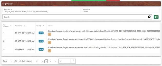

  3. After executing the preceding process, select the View Log hyperlink.
    Figure 6-151 View Log
    This screen displays the process that has already been Run and also indicates a process that can be re-Run. In this case, View Log is a hyperlink that allows you to navigate to the Log Viewer page where you can review any processing errors or alerts related to this process.
  4. Select the Task ID (also known as the Unique System Identifier) to view a report for any processing errors.
    If significant processing errors exist, you must re-Run your process.
    The Break Identification process is complete.
