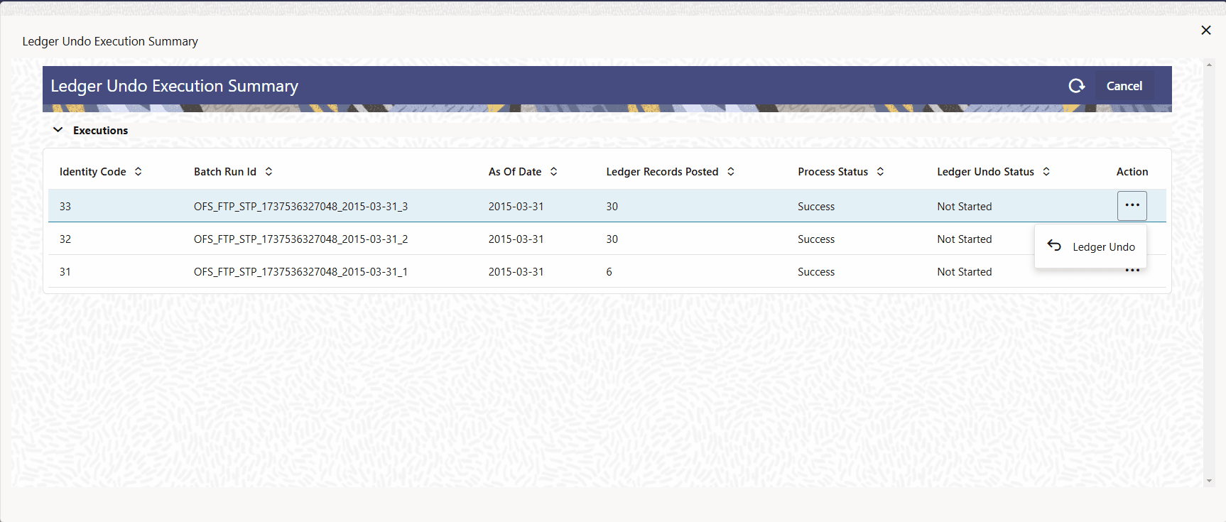

    • Ledger Undo: Select this option if you want to undo/Delete entries posted to management Ledger.
      The Ledger Undo Execution Summary screen displays the Batch execution details, and number of Ledger Records posted. You can select Ledger Undo from Action icon against an execution record. Once done, it will remove all ledger entries corresponding to the selected run.
      Figure 6-121 Ledger Undo Execution Summary
