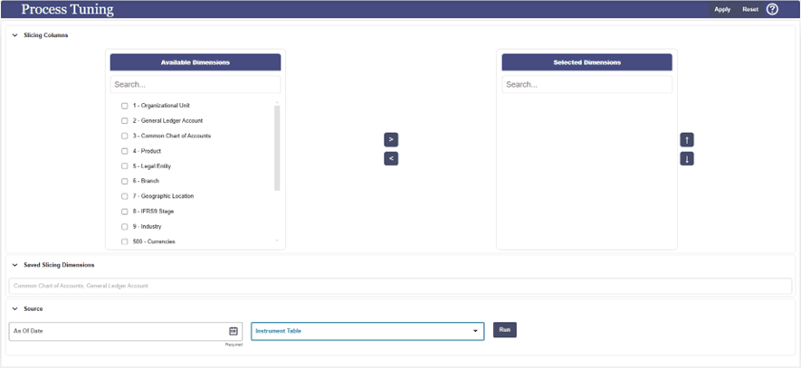

To open the Process Tuning UI:
- From the LHS, select Maintenance, and select
Process Tuning Configuration.
Figure 6-35 Process Tuning
- Select the relevant Dimensions from the Available list of Dimensions and move them
to the Selected Dimensions. You can select up to six dimensions. Users are
recommended to select the Product and Currency dimensions.
You can arrange them using the top, bottom arrows.
- Click Apply.
A confirmation message Slice Dimension has been saved successfully! is displayed. The selected dimensions are saved in FTP_PROCESS_TUNING_DIM_GROUP_SLICE_MAP table.
