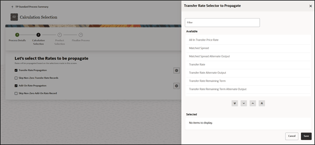

- Navigate to the Transfer Pricing Process Calculation
Selection Block.
Figure 6-38 Transfer Pricing Rule - Calculation Selection
- Select the Propagation parameters:From a Standard Transfer Pricing Process, select the Transfer Rate Propagation option and/or Add-On Rate Propagation option. Selecting Transfer Rate Propagation updates all term-related Instrument Records, which have an Instrument-Level History for a prior period with the Transfer Rate that applied in that Prior Period. If Add-On Rate Propagation is selected, then all Add-On outputs (except Breakage Charges) including Rates and Amounts will be propagated.
If you have pre-populated some Transfer Rates or Add-on Rates before running Propagation and you would like the Propagation Process to skip these records, then select the Skip Non-Zero Transfer Rate Record option and or Skip Non-Zero Add-On rate Record option.For more information, see Transfer Pricing Process.Note that, when a table is updated using a Propagation Pattern, an Instrument Record must satisfy the following criteria to receive a Transfer/Add-On Rate:- It must be an Instrument that exists in both the Target (processing) Table (with the current As-of-Date) and the Source Table (with the prior period based on a matching ID_NUMBER).
