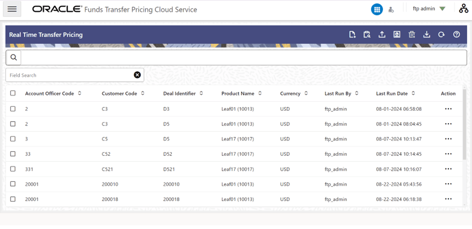

To access the Real-time processing, from the LHS menu, select Funds Transfer Pricing Cloud Service and then select Real Time Transfer Pricing.
Figure 7-5 Real Time Transfer Pricing Summary
A public API is exposed to access real time transfer pricing module from an external application. Every time, this API gets a request for adhoc pricing, a request ID is returned, which can be used to access transfer pricing results.- Account Officer Code
- Customer Code
- Deal Identifier
- Product Name
- Currency
- Last Run By
- Last Run Date
- Action menu: The Action menu displays the following actions that can
be performed on an already defined Product Definitions:
- Edit: Opens the selected product definition screen in edit mode.
- View: Opens the selected product definition screen in view only mode.
- Delete: Displays a pop-up window to confirm the deletion of the selected Product Definition.
- Add: Allows you to a add a new Product Definition.
- Search: Enables you to search for a record definition by As of
Date, Instrument Type, Product Name, Currency, and Account Number/ID Number.
Figure 7-6 Account Search

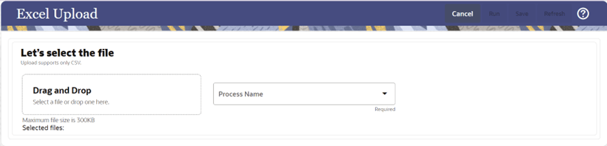

- Excel Upload: Allows to upload the data using an excel sheet. You
can drag and drop an excel sheet and then select the relevant Process Name. Then
you can run the process.
Figure 7-7 Excel Upload
- Execution Summary: Provides the consolidated list of executed product definitions. See Executing a Product Definition.
- Delete: Allows you select one or more products definitions and delete.
- Download: Enables you to download the product definitions report in .csv format.
- Refresh: Reloads the summary screen.
