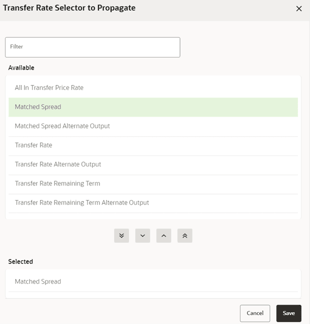

After selecting this option, users need to enable at least one of the TP/Add-On Rate propagation options. - Transfer Rate Propagation: Select Transfer Rate
Propagation and click the Settings icon to
select the Rate need to be propagated.
Figure 6-138 Transfer Rate Selector to Propagate
For Duration and Average Life Propagation, you can use the Task component "FTP Propagation.- Select the relevant option for the Transfer Rates that you want to propagate from the Available block and use the Move buttons to move them to the Selected block.
- Click Save.
