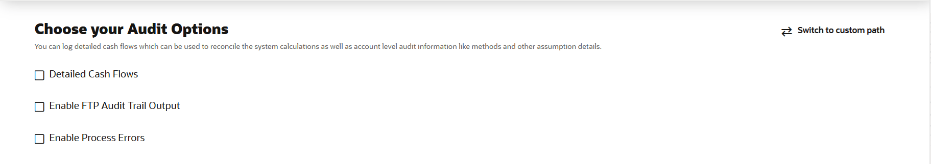

Figure 6-137 Audit Options
Audit Options
Within the Audit Options screen, you can choose to log the detailed Cash Flows. Later you can retrieve Cash Flows from the FTP_O_CASH_FLOW_OUTPUT_HIST table.
In addition, the Enable FTP Audit Trail Output option allows you to capture the audit details in FTP_O_ENGINE_AUDIT_TRAIL_AGGR table.

Select Enable Process Errors if you want to log the process errors.
