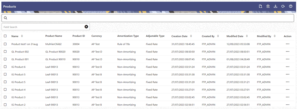

The Products window shows the list of all the defined Product Characteristics for standard products and you can define/edit the properties for these standard products.

Figure 6-164 Products screen
Products screen

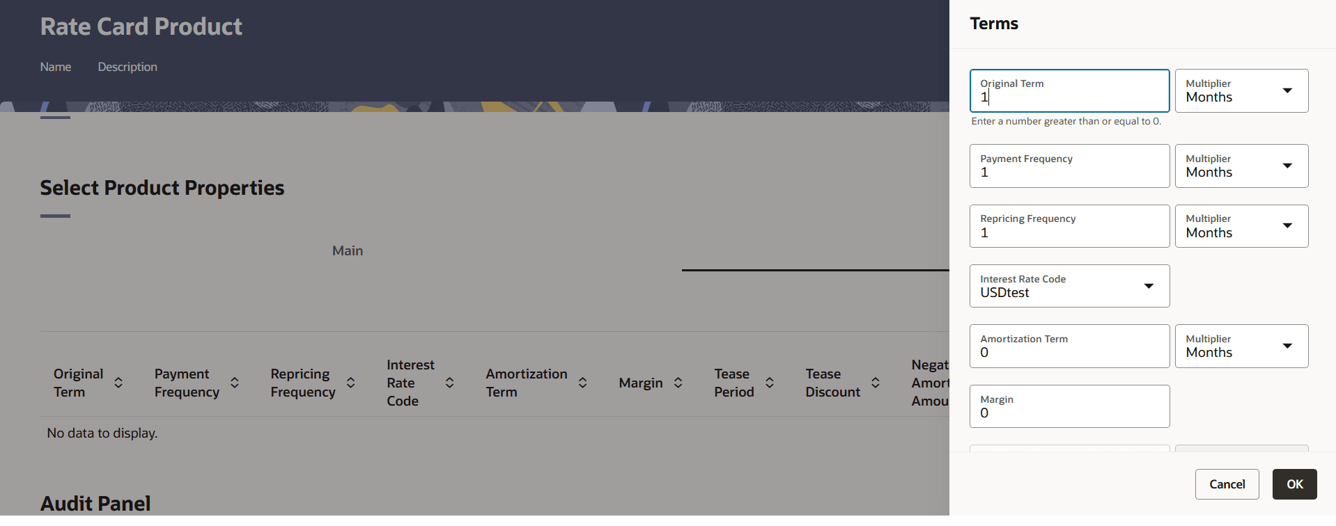

    Term Tab
    Original Term Enter the Original Term to define the contractual term from the origination date. Note that it is possible to define more than one term for the selected product/currency. If more than one term is defined, then multiple records are created for pricing, i.e. one corresponding to each Product/Currency and Term.
    Payment Frequency Enter the payment frequency. This allows you to define the frequency of payment.
    Repricing Frequency Enter the Repricing Frequency to define the frequency of rate change of a product.
    Amortization Term Define the assumed term used for payment calculation purposes. This will be equal to the Original Term of the instrument. It should only be different in cases where the instrument does not fully Amortize over the life of the product. i.e. there is a lump sum payment due on the maturity date.
    Interest Rate Code Enter the Interest Rate Code to be used for finding the coupon rate on the product.
    Margin Enter the margin that is the contractual spread, which is added to the pricing index and results in the financial institution's retention (net) rate.
    Tease Period
    Define the Tease Date, that is when the Tease Rate (introductory rate) ends and the normal product rate begins.
    The default value is 0 Months.
    This entry is disabled, if the Adjustable Type (defined from Main Tab) is a Repricing pattern or fixed.
    Tease Discount Enter the Tease Discount. The default value for tease discount is 0.0000. This entry is disabled if the Adjustable Type is a repricing pattern or fixed rate or if the teasing period is zero.
    Commitment Start Date The commitment start date defaults to the system date.
    Commitment Term Enter the commitment period term in Days. Based on this input the commitment end date is calculated.
    Commitment End Date The commitment end date is calculated automatically based on the commitment start date and commitment term.
    Negative Amortisation Amount The total amount of principal added to outstanding principal, resulting from payments which were not large enough to cover interest due.
    Maturity Amount This optional column is used when AMRT_TYPE_CD = 850 (Annuity). Maturity Amount is an optional input, and represents the value (principal and accrued interest) of the record at the maturity date for annuities.
    Residual Amount Used for instruments with AMRT_TYPE_CD = 840 (Lease). This column represents the residual value of the lease at the maturity date.

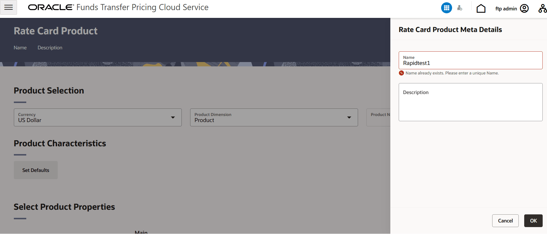

  1. Provide a unique name for your rate card product definition.
  2. Enter few details as description for your rate card product definition.

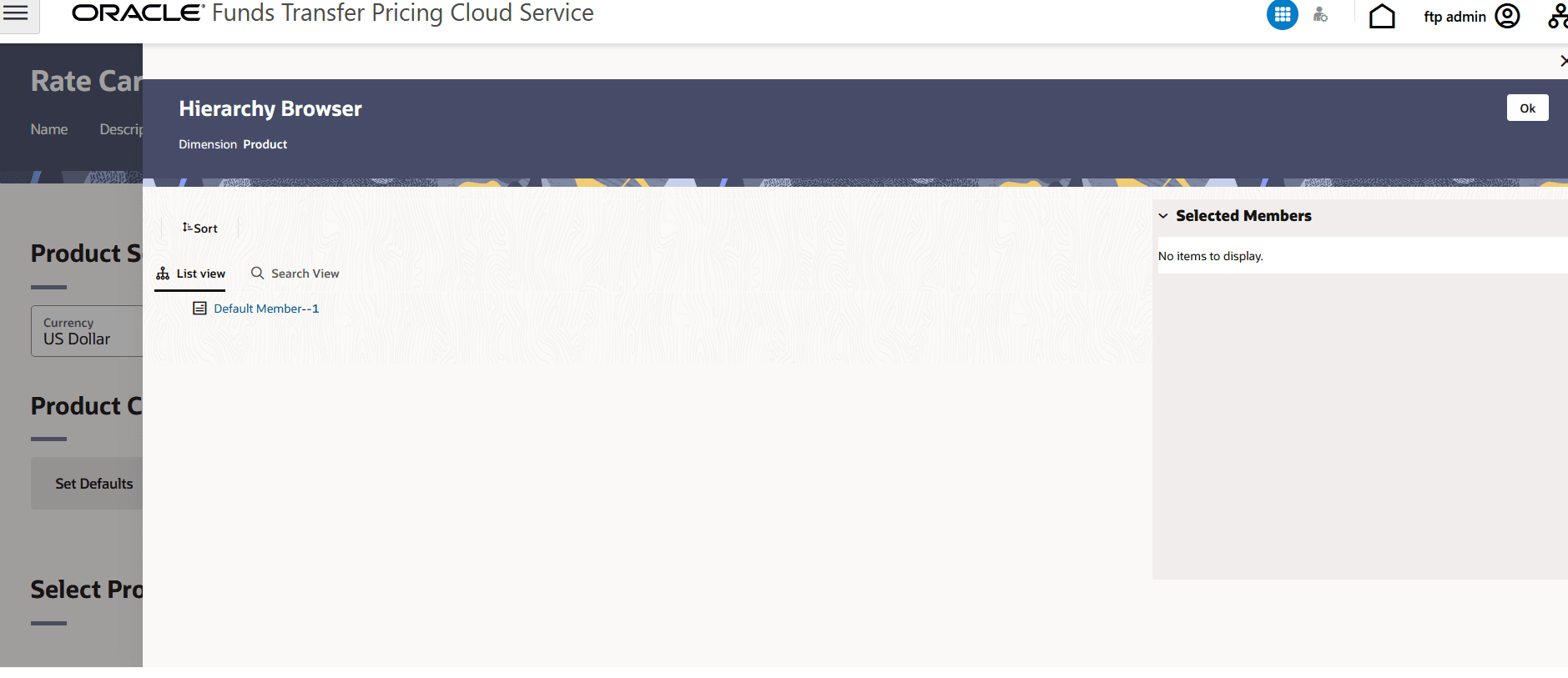

  3. Select a standard Product using the hierarchy Browser.
    Figure 6-166 Hierarchy screen
    The Hierarchy screen allows you to select the product hierarchy.

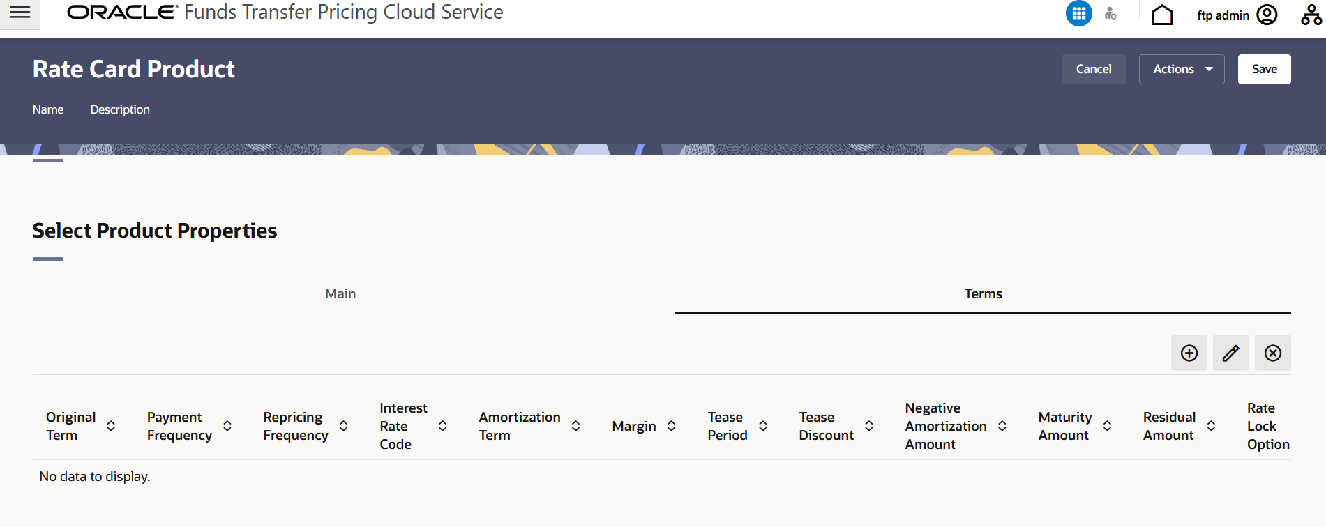

  6. Define the properties of the Product in the Terms tab.
    Figure 6-168 The Product Definition – Terms Tab
    The Product Definition – Terms Tab allows you to enter and select the Terms for the product.
    Under a single product/currency selection, users may define multiple combinations of Original Term, Payment Frequency, and Repricing Frequency. This is done by adding records using the "+" icon. Multiple records are useful when generating daily pricing sheets, where the standard product has multiple terms. For example, the product could be "Term Deposits", but users may want to view the daily FTP Rates for each available term, for example, 3 months, 6 months, 12 months, 18 months, and 60 months. This example is possible by adding and defining multiple records under a single product/currency selection. For more information on the meaning of each of these fields, see the OFS Cash Flow Engine Reference Guide.
