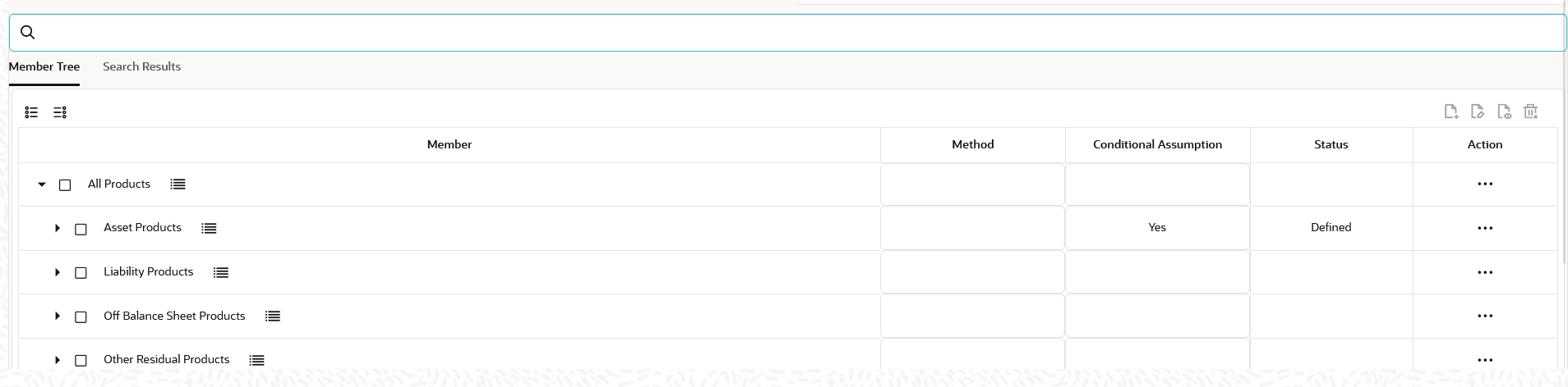

To define conditional assumption, follow these steps:
  1. Navigate to Conditional Assumptions section.

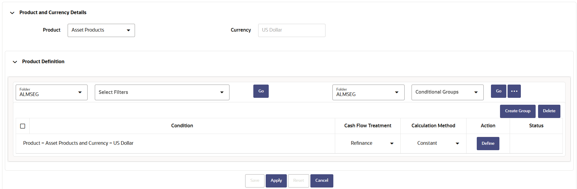

    Figure 6-108 Conditional Assumption

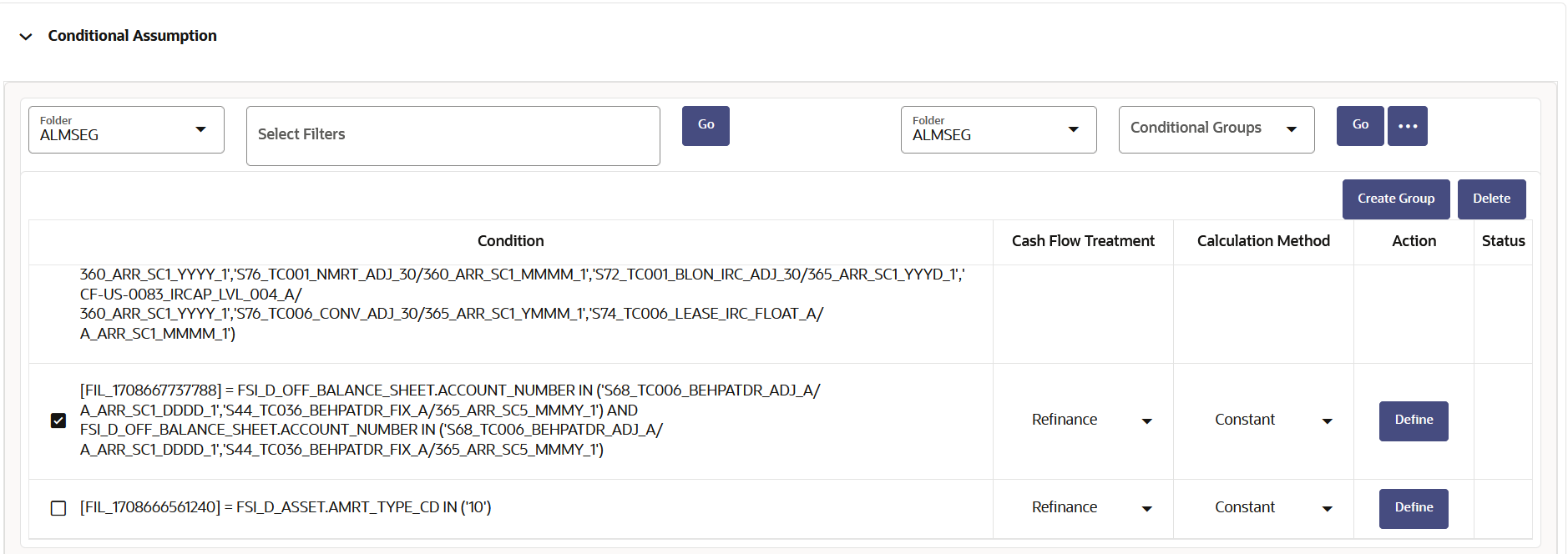

    Figure 6-109 Conditional Assumption
  2. Select the Filter Folder and Filter, then click Go. The condition is displayed based on selected filter.
  3. Here, you can select either group of conditions using Conditional Group or Individual condition using the filter section.
    • You can select the conditional groups from the Conditional Group drop-down. You can create a new condition group using the Create Group button. To create a new condition group, follow these steps:
      1. Select filters using the Filter drop-down list.
        You must select more than 2 filters to define a condition group.
      2. Select the conditions (filters) using the corresponding check-boxes.
      3. Click Create Group .
      4. The Save Condition Group window is displayed. Provide the Group Name and select the Folder where you want to save the condition group. Click Save in Save Condition Group window. You can use this saved group from Condition Group down-down.
    • Else, select Individual condition using the corresponding check-box.
  4. Select Cash Flow Treatment as Curtailment or Refinance.
  5. Select Calculation Method as Constant, Prepayment Model, PSA, or Arctangent..
  6. Click Define.

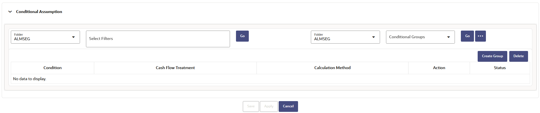

    Figure 6-110 Conditional Assumption
    Use Delete button to delete the defined condition(s)
  7. Define Prepayment rule and Seasonality, and then click Apply. The status of condition assumption is updated as Defined.

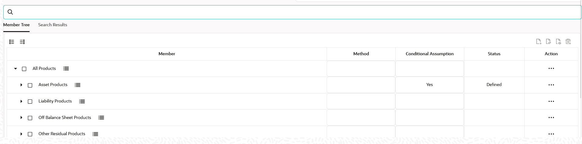

  8. Click Save. The status of conditional assumption is also updated in Assumption Browser.
    Figure 6-111 Status of Conditional Assumption
