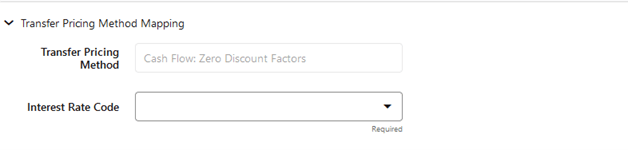

Figure 6-56 Cash Flow: Zero Discount Factors
