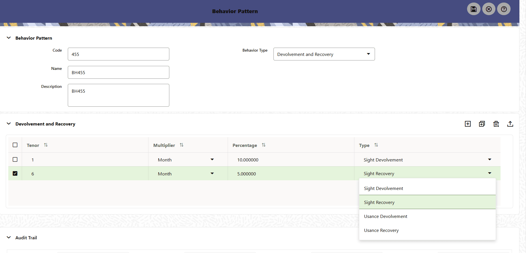

  1. In the Behavior Pattern Details Page, select Devolvement and Recovery as the Behavior Pattern Type.
  2. Click the Add icon to open the Non-Performing Behavior Patterns Summary Page.
    Figure 6-24 Behavior Pattern with Type as Devolvement and Recovery
  3. Enter or select the following details:

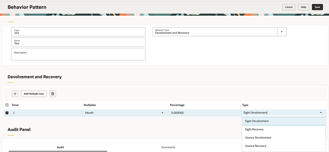

    • Type: This allows you to classify the Runoff based on the appropriate type. The options are:
      • Sight Devolvement: indicates the Beneficiary is paid as soon as the Paying Bank has determined that all necessary documents are in order. This is the preferred approach.
      • Sight Recovery
      • Usance Devolvement: Usance: is a period, which can be between 30 and 180 days after the bill of Lading Date.
      • Usance Recovery
    There is no difference in behavior from a Cash Flow perspective, but the Runoff Amount will be written to a Principal Runoff Financial Element corresponding to the selected Runoff Type.
  4. Click the Add icon to add additional payment strips to the Pattern and define appropriate assumptions for each strip.
  5. To delete a row, select the check box corresponding to the row(s) you want to remove and click the Delete icon.
  6. Click Save.
