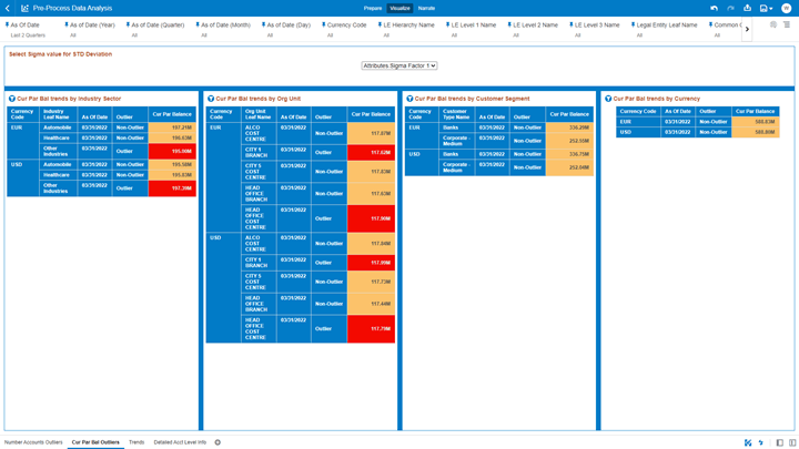

This canvas allows you to look at the Current Par Balance Outliers that are calculated using the Standard Deviation capability available off the shelf with Oracle Analytics.
The Current Par Balance pertaining to the Instrument level data is segregated between “Outlier” and “Non-Outlier” in the report column “Outlier”.
“Outlier” in this case refers to the Current Par Balance, for a particular subset related to a combination of Dimensional Values that lie outside the confidence interval of the deviation that we are adopting in our technique.
“Non-Outlier” would refer to the Current Par Balance, for a particular subset related to a combination of Dimensional Values that lie inside the confidence interval of the deviation.
The Outliers are calculated on the Current Par Balance aggregated by the respective combination of Dimensional Values, such as Industry, Org Unit, Customer Segment, and Currency against the As-of-Date available.
Figure 8-123 “Cur Par Bal Outliers” Report Canvas
The Current Par Balance can be identified as an Outlier or a Non-Outlier based on the standard deviation confidence interval that we adopt.
This confidence interval is parametrized with the list of the Sigma values available in the report that is “Attributes.Sigma Factor 1”, “Attributes.Sigma Factor 2”, and “Attributes.Sigma Factor 3”.
The Sigma Factors are integer values that range from “Attributes.Sigma Factor 1” to “Attributes.Sigma Factor 3” in the increasing order of the conservativeness or the confidence interval of the Standard Deviation.
This means will have more Outliers when you perform analysis with “Attributes.Sigma Factor 1” than with the “Attributes.Sigma Factor 3”.

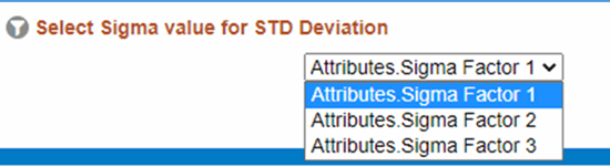

The following screenshot shows the selection for the Sigma Factor available in the report canvas.
Figure 8-124 Sigma Factor Selection for STD Deviation
You can use a series of Report Prompts, as previously described, to filter the data according to Key Attributes pertaining to the underlying Instrument level data.
The report displays the underlying Instrument account data according to the following Charts’ logic:
  • Select Sigma Value for STD Deviation: The chart provides you with a selection capability for the desired Sigma value to be used by the STD Deviation, the possible selection values are “Attributes.Sigma Factor 1”, “Attributes.Sigma Factor 2”, and “Attributes.Sigma Factor 3”.
  • Cur Par Bal trends by Industry Sector: This chart deduces if the Current Par Balance related to the different Industry Sectors is an “Outlier” or “Non-Outlier” for a combination of As-of-Date, Currency (transaction currency), and Industry Leaf Name.
    The columns displayed in the chart are as follows:
    • Currency Code
    • Industry Leaf Name
    • As Of Date
    • Outlier
    • Cur Par Balance
  • Number of Accounts trends by Org Unit: This chart deduces if the Current Par Balance related to the different Org Units is an “Outlier” or “Non-Outlier” for a combination of As-of-Date, Currency (transaction currency), and Org Unit Leaf Name.
    • Currency Code
    • Org unit Leaf Name
    • As Of Date
    • Outlier
    • Cur Par Balance
  • Number of Accounts trends by Customer Segment: This chart deduces if the Current Par Balance related to the different Customer Segments is an “Outlier” or “Non-Outlier” for a combination of As-of-Date, Currency (transaction currency), and Customer Type Name.
    • Currency Code
    • Customer Type Name
    • As Of Date
    • Outlier
    • Cur Par Balance
  • Number of Accounts trends by Currency: This chart deduces if the Current Par Balance related to the different Currencies is an “Outlier” or “Non-Outlier” for a combination of As-of-Date and Currency Code.
    • Currency Code
    • As Of Date
    • Outlier
    • Cur Par Balance
