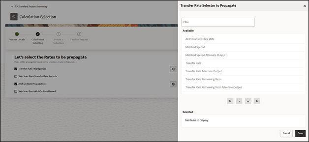

Depending on your requirements, you can choose to propagate Transfer Rates, Add-On Rates by selecting the appropriate Propagation Processing Option in the Transfer Pricing Process.
To propagate the Transfer Pricing Results:
  1. Navigate to the Transfer Pricing Process Calculation Selection Block.
    Figure 6-40 Transfer Pricing Rule - Calculation Selection
  2. Select the Propagation parameters:
    From a Standard Transfer Pricing Process, select the Transfer Rate Propagation option and/or Add-On Rate Propagation option. Selecting Transfer Rate Propagation updates all term-related Instrument Records, which have an Instrument-Level History for a prior period with the Transfer Rate that applied in that Prior Period. If Add-On Rate Propagation is selected, then all Add-On outputs (except Breakage Charges) including Rates and Amounts will be propagated.
    If you have pre-populated some Transfer Rates or Add-on Rates before running Propagation and you would like the Propagation Process to skip these records, then select the Skip Non-Zero Transfer Rate Record option and or Skip Non-Zero Add-On rate Record option.
    For more information, see Transfer Pricing Process.
