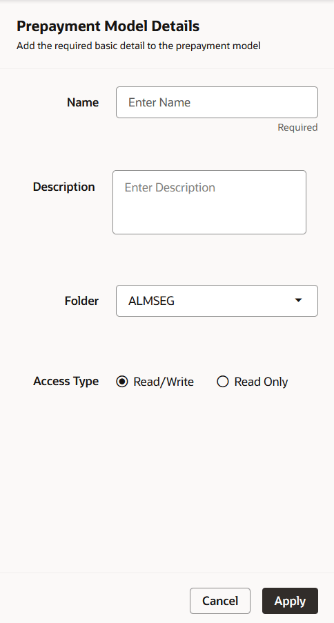

  2. Click Add. The Prepayment Model Details Page is displayed.
    Figure 6-122 Prepayment Model
    Prepayment Model
  3. Enter the following details:
    • Name: Enter the name and a brief description for the Prepayment Model. The name you assign to the Prepayment Model must be unique. The name can hold a maximum of 30 characters.
    • Folder: Select the Folder
    • Description: Enter the description of Prepayment Model Rule.
    • Select Access Type.
  4. Click Apply.
