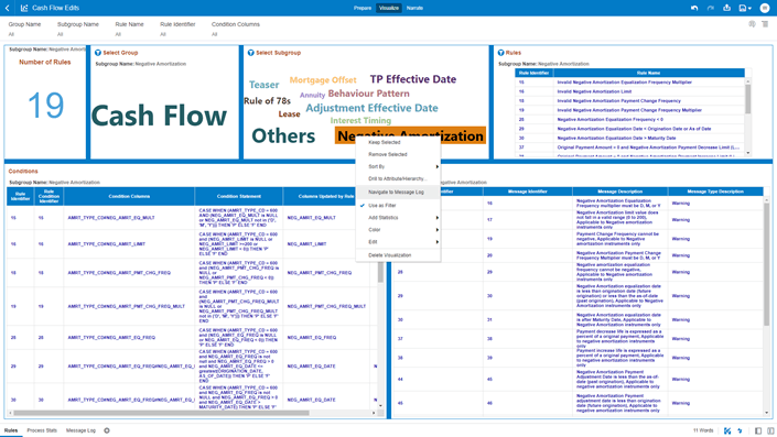

The Data Actions provide the capability to perform drill-down analysis across the downstream report canvases. The drill-down is enabled using a Data Action.
From “Rules” and “Process Stats” report canvases charts, you can select a combination of values, and then perform the navigation to the “message Log” report canvas.
To do so, with a right-click on the chart selection, the Data Action options will appear for you to be able to navigate further as described in the following mapping:
  • Navigate to Message Log – the Data Action will be drilling through the “Message Log” canvas.
The following screenshots show the Data Action list as well as the navigation options that appears once you right-click on the desired selection.
Figure 8-134 Data Action Configuration
Figure 8-135 Data Action for Drill-down with report Canvases
