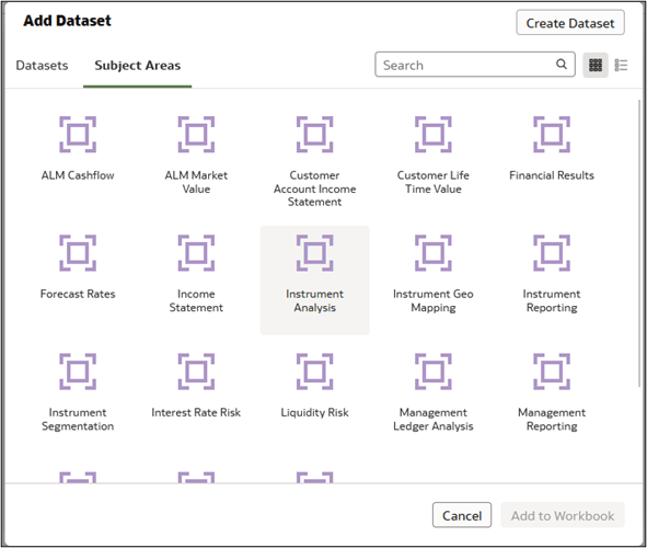

    This opens the Add Dataset window.
  3. Select the Subject Areas tab. You will find all the relevant subject areas listed as follows.
    Figure 8-17 Subject Areas
    Subject Areas

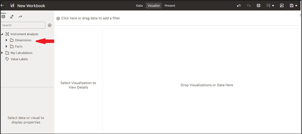

  4. You can double click to select a particular Subject Areas and a new canvas will open up with the elements of the selected subject area.
    Figure 8-18 New Workbook
    New Workbook
  5. Expand the Dimensions and Facts and drop the relevant items on to the canvas. By default the best visualization/ chart type for the given data is displayed.
