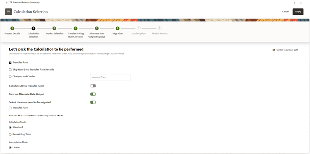

6.3.9.3.2 Calculation Selection
The Calculation Selection screen displays various calculation options that you can select. Depending on the choices you make, the progress train on the screen include few optional steps like Audit, Migration, and Prepayment Rule selection. In the below sample screen, the options Turn On Alternate Rate Output and Select the rates need to be migrated are selected; accordingly progress train on the top, starts displaying the Alternate Rate Output Mapping and Migration options as well.
You can switch the UI to a Custom Calculation Selection at any time. Clicking Switch to custom path will help you if you realize given calculation options in selected scenario, does not have all the required calculation and you like to customize the selection. When you enable the custom flow, a confirmation message is displayed to confirm the re-routing to custom flow.

  1. Select the following:
    • Transfer Rate: This is mandatory selection for the flow. System picks the transfer pricing method defined in TP rule and perform the TP rate calculations accordingly.
    • Skip Non-Zero Transfer Rate Records: Select this option if you have already populated Transfer Rates through a separate process. In addition, would like to skip the records where transfer rate is already populated.
      In the propagation flow, use the Skip Rolled Over Accounts (Last Period) option to skip the accounts that were rolled over in the last period as these accounts received a weighted rate for the last period, which is not applicable for propagation. If rates need to be propagated for rolled-over accounts, leave this option unselected.
    • Charges and Credits: Choose the Charge/Credit calculation, to calculate and output the Instrument level TP charges and credits. If you select the Instrument Charge/Credit option, you must also choose between Monthly and Daily charge/credit accrual. The default selection is Monthly. If Daily is selected, another check-box Charge/Credit Transfer Rate Accumulation is displayed. If you want to use the holiday calendar for charge credit calculation, you can define it within the TP rule for each available product/currency to determine the number of days to accrue.

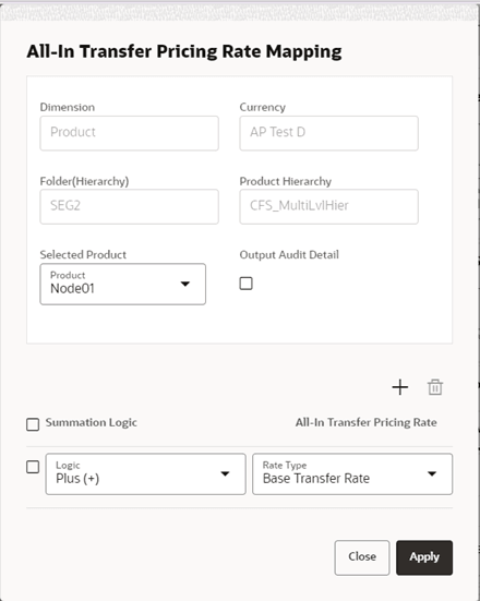

    • Calculate All-In Transfer Rates: Choose this option if you want the TP Process to calculate and post the All-in Transfer Rate for each Instrument Record. This option allows you to define the aggregation logic for combining any Add-on Rates on top of base Transfer Rate. In the product selection widget, when you select the Search icon, you can define for each product the Rates to include in the calculation and the related signage for each Rate.
      To define the All-in Transfer Rate, enable the Calculate All-In Transfer Rates toggle switch.
      Select the All-in Transfer Rate check-box and then click the Settings icon to display the All-In Transfer Rate Mapping Selector window. Select the Node under Assumption Browser and click the Action icon, and then click Add. The All-In Transfer Pricing Rate Mapping window is displayed.
      This window allows you to define different formula for different product and currency combinations.
      You can search the process on any of the product dimension, searched dimension will be auto-populated while defining the process or configuring the All-in-TP rate calculations; if you like, you can change the default product dimension.
      Figure 6-136 All-In Transfer Rate Mapping Selector
      Here, you can define, different all-in TP formula for different product, currency combinations.
      Figure 6-137 All-In Transfer Rate Mapping
      Click the + button to add a Summation Logic. Select the relevant Logic and Add-On Rate Types and click Apply.
      In the Transfer Rate Mapping Selector window, select a different currency and select the Node, and then click the Action icon to add another mapping. Repeat the above steps and create the calculation logic for the selected currency.

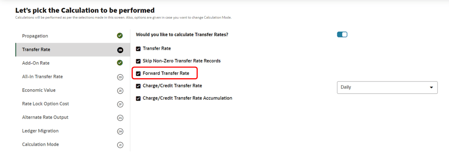

Transfer Rate Calculations based on Forward Curve
After you enable the Transfer Rate for forward starting instruments like Loan Commitments, a Forward curve will be used for Transfer Rate calculations. To enable the feature, you can select Forward Transfer rate check-box.
Figure 6-138 Forward Transfer Rate
