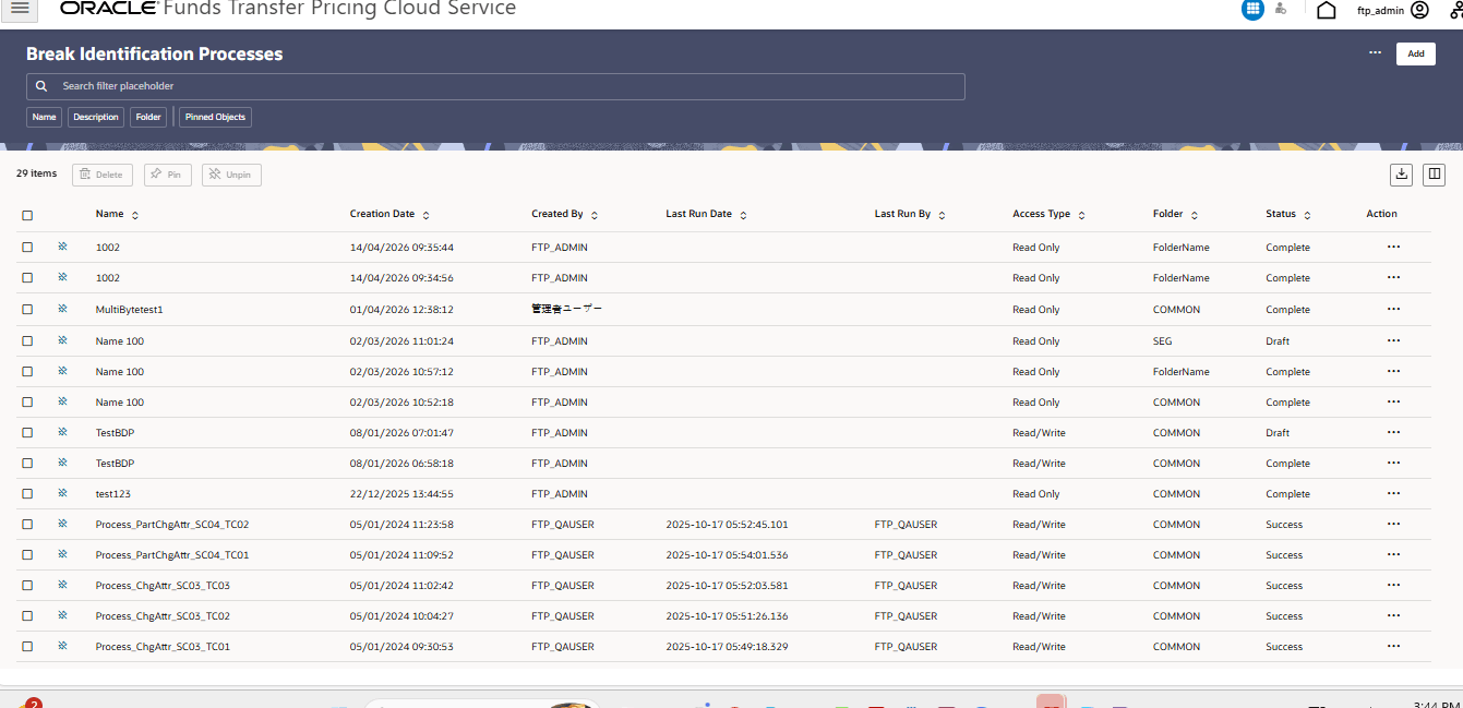

  1. From the LHS menu, select Operations and Processes and select Break Identification Process.
    The Break Identification Process summary page is displayed.
    Figure 6-158 Break Identification Process Summary page
  2. Click Add.

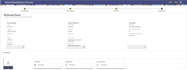

  8. Select the Finalize Process in the screen.
    If you want to edit any of the prior steps, you can directly do it from this screen.
    Figure 6-162 Finalize Process screen
    This screen allows you to Freeze the Process with the selected parameters.
  9. Select Apply to complete the process.
