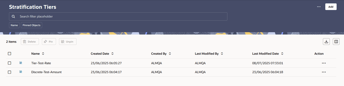

Data Stratification Tiers Summary
Figure 3-67 Data Stratification Tier

The Data Stratification Tiers Summary displays the following information:
Add: Click the Addbutton on the page header to build a new Stratification Tier.
More Actions: Enables you to perform following tasks.
  • Refresh: Retains the selected filters and refreshes the summary page with latest status.
  • Reset: Clears the selected filters and refreshes the summary page.
  • Help: Redirects you to latest documentation.
Delete: Enables you to select and delete one or multiple rules in the table simultaneously.
Pin/Unpin: Enables you to pin/unpin the selected rule.
Export: Enables you to download the summary page details in .CSV format.
Columns: Allows you to view the summary page data using a customized list of columns.
The Data Stratification Tier summary table displays the following columns:
  • Name: The Stratification Tier name.
  • Created Date: The Date and Time when the Stratification Tier was created.
  • Created By: Displays the Name of the user who created the Stratification Tier.
  • Last Modified By: Displays the Name of the user who last modified the Stratification Tier.
  • Last Modification Date: The Date and Time when the Stratification Tier was last modified.
  • Actions: Click this icon to view a list of actions that you can perform on the Stratification Tier.
    • View: View existing Stratification Tier.
    • Edit: Edit existing Stratification Tier. To edit a rule, you must have Read/Write privilege.
    • Delete: You can delete rules that you no longer require. Note that only Stratification Tier owners and those with Read/Write privileges can delete rules. A Stratification Tier that has a dependency cannot be deleted. A Stratification Tier cannot be retrieved after deletion.
    • Dependency Check: You can check dependencies for rules to know where a particular Stratification Tier has been used. This also prevents accidental deletion of rules having dependencies. Click on the Action icon against the Stratification Tier Name and select Dependency Check to generate a report on all Rules that utilize your selected Stratification Tier.
