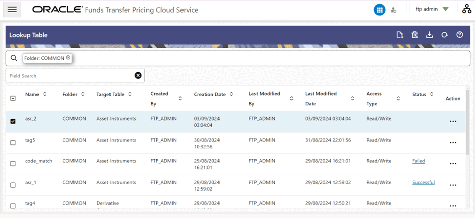

The user data is generally matched conditionally with the similar columns of a PBSMCS instrument table and a user specified value is returned that is stored under the return columns of the Lookup table. To open the Lookup Table summary screen, from the LHS menu, select Funds Transfer Pricing Cloud Service, select Operations And Processes, and then select Lookup Table.
Figure 7-1 Lookup Table summary screen
Using search criteria, you can control the set of rules displayed. When you Add, Edit, or View a rule, it displays a detailed screen.
The Lookup Table summary screen has two panes: Search and Lookup Table summary table.

This section presents a table containing all of the Lookup Tables that meet your search criteria. The table displays the details of the already created Lookup Tables.
The Lookup Table summary table displays the following details:
- Name: Displays the Lookup Table’s short name. Hovering over an Lookup Table name displays the Lookup Table’s object code and the object ID.
- Folder: Displays the folder in which the driver rule has been created.
- Target Table: Displays the tags associated with the rule.
- Created By: Displays the name of the user who created the Lookup Table rule.
- Creation Date: Displays the date and time at which an Lookup Table rule was created.
- Last Modified By: Displays the name of the user who last modified the Lookup Table rule.
- Last Modification Date: Displays the date and time at which an Lookup Table rule was last modified.
- Access Type: Displays the “Read/Write” or “Read Only” property of an Lookup Table rule. Only the creator of a rule may change its Access Type.
- Status: Displays the status of the Lookup table. The values that are possible as status are – ‘Creation in Progress’, ‘Table Created’, ‘Failed’ and ‘Deletion in Progress’.
