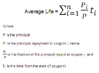

6.3.4.1.1 Cash Flow: Average Life
The Average Life Method determines the average life of the instrument by calculating the Effective Term required to repay half of the principal or nominal amount of the instrument. The Transfer Pricing Rate is equivalent to the rate on the associated Interest Rate Curve corresponding to the calculated term.
Figure 6-52 Cash Flow: Average Life
Figure 6-53 Cash Flow: Average Life Formula
This illustration shows the formula to calculate Cash Flow: Average Life.
Oracle Funds Transfer Pricing Cloud Service derives the Average Life based on the Cash Flows of an instrument as determined by the characteristics specified in the Instrument Table and using your specified Prepayment Rate, if applicable. The average life formula calculates a single term, that is, a point on the yield curve used to transfer the price of the instrument being analyzed. The Average Life Calculation does not differentiate between fixed-rate and adjustable-rate instruments. It applies the same calculation logic to both. It computes the Average Life of the Loan (to maturity).
