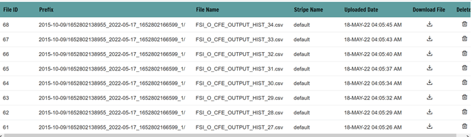

    After the batch is completed successfully, navigate to Data Management Tools, select the Data File Administration, and then select File Upload and Download. Download the exported file from object store.
    Figure 3-127 Cash Flow Output Export
    You can define the maximum number of rows to include in the file using the EXPORT_FILE_ROW_COUNT. For more information, see the Application Preferences.
    For example, if you have 11000 records in a table and the EXPORT_FILE_ROW_COUNT parameter is set to 10000, then two part files will be created. The first file will have 10000 records and the second file will have rest 1000 records. When these part files are created, a suffix number such as _1, _2 and so on will be added to Name of these files.
    The File Name Column shows the name of file with Part number. The Prefix is displayed as a combination of As of Date, Process ID and Run execution ID.
