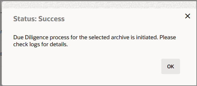

- Click Select DueDiligence. The status of Archive is displayed. For more
information on status, see Table Status Details. Click Ok.

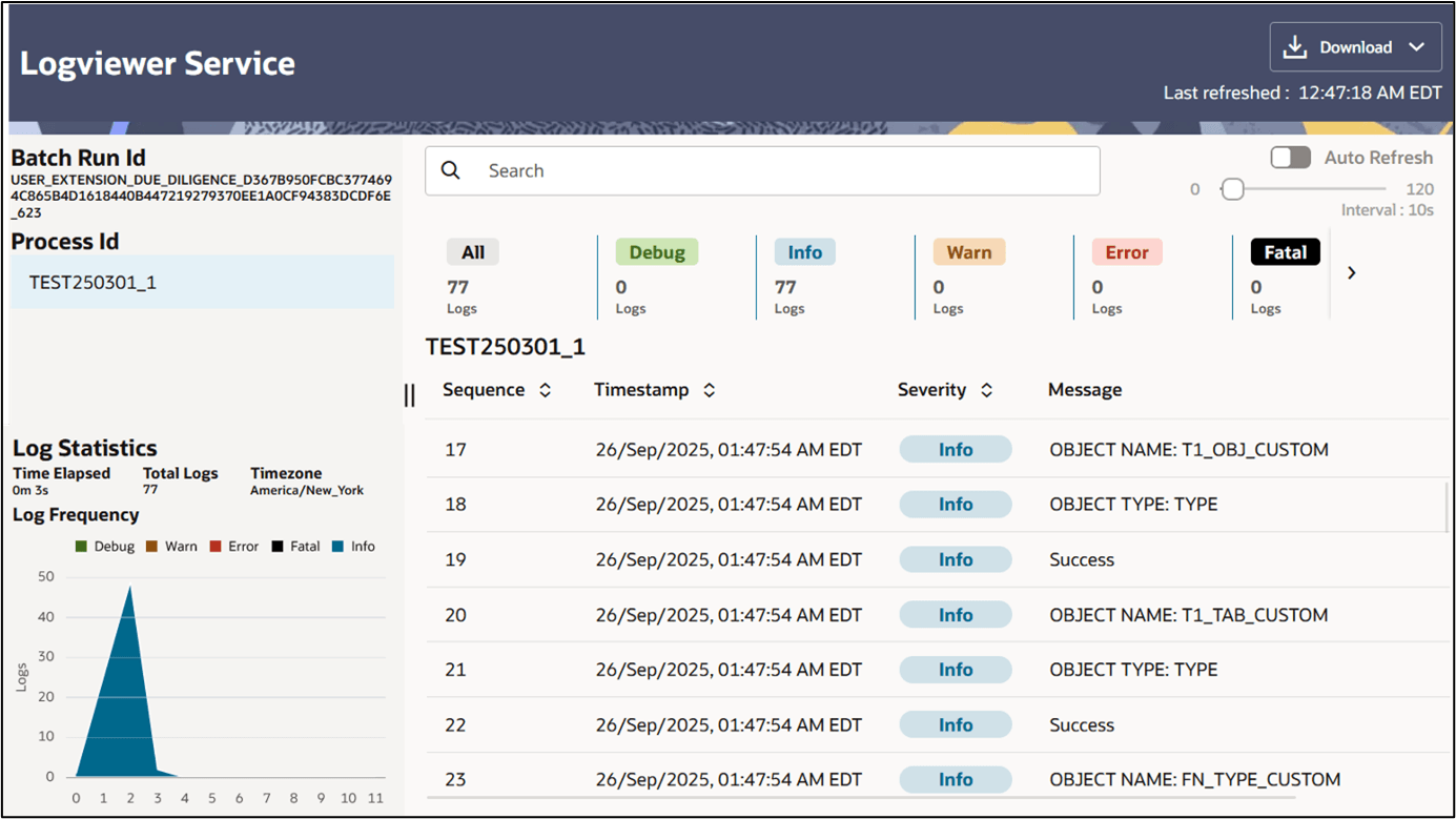

- View Log: Allows you to access the log details post Due Diligence check.
Figure 4-27 Logviewer Service
