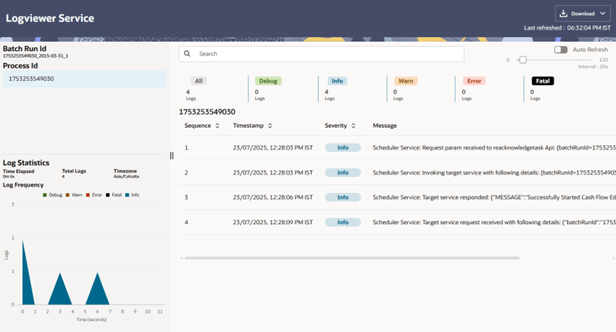

  4. Click any Execution ID to view the log details. The Logviewer window shows the complete details of process along with Batch Run ID Information.
  5. Click Download to export the details of cash flow edits in csv format. This will help you to understand errors found in instrument data. You can use the Auto Refresh button to refresh the log status in the Logviewer window.
    Figure 3-115 Logviewer window
    Logviewer window
