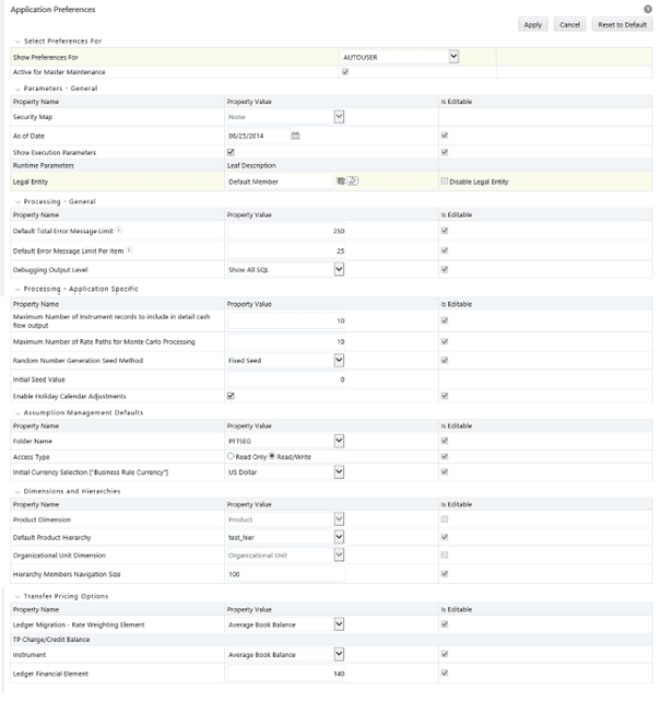

  1. From the LHS menu, select Funds Transfer Pricing, and then select Application Preferences to display the Application Preferences page.
    Figure 14-1 Application Preferences page
    The Application Preference screen allows you to define the preferences that are used by the Funds Transfer Pricing application. This is a one-step process and defined the first time when you are going to use the application.

  2. Input the values for all the line items.
    If you are the application administrator, define default values for the “All User” group by making the appropriate selection from the drop list at the top of the page. Pay particular attention to the “Is Editable” status and determine which items require administrative control and which items non-administrative users will be able to set for themselves.
  3. Select Apply to confirm changes.
