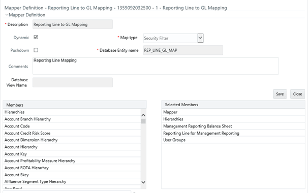

Similarly, a Mapper object provides the necessary reference to one or more hierarchies, when dimension/hierarchy data is needed to define conditional logic. In the following example, this map refers to a hierarchy created on the Organization Unit dimension.
Figure 11-12 Mapper Definition- Reporting Line to GL Mapping

To do the map maintenance:
  1. Select Common Object Maintenance from the LHS menu, select Unified Analytical Metadata, and then select Map Maintenance.
  2. Click the Add icon to create a new Map.
  3. On the left-hand side, select one or more hierarchies that were enabled in the initial step.
  4. Enter the required information, for example, Name, Effective Dates, and Entity Name.
  5. Click Save.
  6. From the Map Maintenance summary page, select the Map, and then select the Mapper Maintenance icon.
    Here, you will see the hierarchy and all parent/child relationships.

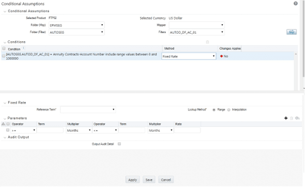

The Conditional Assumption screen allows users to select explicit conditions (from Data Filters and/or Maps) and apply methods and rule selections to each condition directly. The Filter Conditions are processed by the engine in the order that they appear on the screen. After a condition is satisfied, the related assumption is applied. The following figure displays a representative Conditional Assumption using a Data Filter:
Figure 11-13 Conditional Assumptions
This illustration allows you to define the Conditional Assumptions.
If an instrument record does not meet any of the conditions, then the rule logic reverts to the standard assumption that is directly assigned to the Product / Currency combination. In the example below, you can see that Fed Funds has both a direct assignment and a conditional assumption. If the condition is not met, the “Fixed Rate” assumption (ELSE condition) will be applied. For Reverse Repo's, there is only a Conditional Assumption. In the absence of an ELSE assumption, the engine will use the conditional assumption in all cases for the Product/Currency pair. To avoid this, users should define the Standard/Else assumption with appropriate input.
