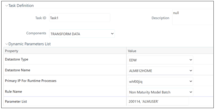

  4. Click the Add button under the Task Details section.
    Figure 25-1 Task Details section
  5. Define the Task ID and Description.
  6. Select Components as TRANSFORM DATA.
  7. Input the following required parameters:
    • Datastore Type: Select appropriate datastore from list
    • Datastore Name : Select appropriate name from the list
    • Primary IP for Runtime Processes: Select the IP address from the list
    • Rule Name: Non Maturity Model Batch
    • Parameter List: System ID, User Name
    Enter the parameters in the following format: 200114, ‘ALMUSER’
    Here, 200114 is System ID and ALMUSER is User Name
