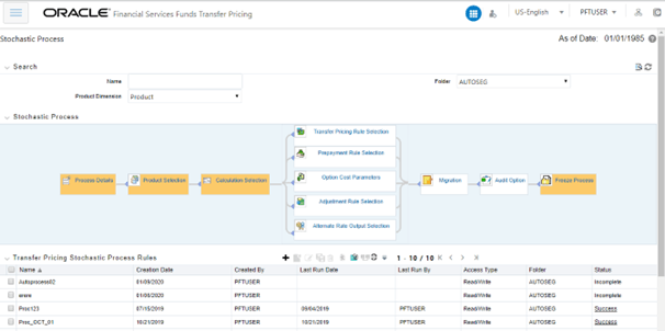

To create and execute the stochastic transfer pricing process:
  1. From the LHS menu, select Funds Transfer Pricing, select FTP Processing, and then select the Stochastic Process.
    Figure 31-11 FTP Processing - Stochastic Mode summary page
    This screen displays the summary of the Stochastic Mode for the FTP Processing.

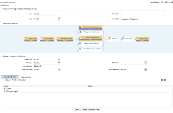

  4. Product Selection Block:
    Figure 31-12 Stochastic Process - Product Selection
    This screen allows you to select the Product for the Stochastic Process.
    1. Select a Product Hierarchy and select nodes from the hierarchy corresponding to data you want to include in the process.
    2. Alternatively, select the Source Selection button, and select the instrument tables corresponding to the data you want to include in the process.
    3. Select a Filter (optional), to constrain the data to be included in the process. Filters work as a secondary constraint, applied after the data set is determined based on Product Hierarchy Member Selection or Source Selection.
      Tip:
      Before using the product hierarchy approach for selecting data to include in your process, there is a procedure that must be Run (“PRODUCT TO INSTRUMENT MAPPING”). This procedure can be executed from the Batch Scheduler – Run - interface.
      The purpose of the Product to Instrument mapping procedure is to scan all instrument tables (FSI_D_xxx) and populate the mapping table (“FSI_M_PROD_INST_TABLE_MAP”) with a listing of the product dimension members that exist within each instrument table. When you select Products (parents or children) within an ALM or FTP process definition, the process refers to this mapping table to identify the instrument tables to include in the process.
      It is recommended that you establish an internal process whereby this procedure is executed after every data load to ensure that mappings are up to date.
      For more information on the Product to Instrument Mapping Procedure, see OFS Data Model Utilities User Guide.
    4. Select Source from Source Selection.
      You can select both Ledger Stat and New Management Ledger table at the same time. You can select only one Ledger Table per FTP process, either Ledger Stat or the Management Ledger. Multiple Instrument tables are allowed as usual. The engine is using the selected Ledger Table for both Direct Transfer Pricing of Ledger Balances and Ledger Migration. Therefore, the engine will work only on one Ledger Table, not on multiple within any single FTP Process.
    5. Select Apply.

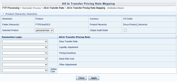

    5. Choose All-in Transfer Rate (optional) if you want the TP process to calculate and post the All-in Transfer Rate for each instrument record. This option allows you to define the aggregation logic for combining any Add-on Rates with the base Transfer Rate. When you select the search icon, you can define for each product the rates to include in the calculation and the related signage for each rate.
      Figure 31-13 Stochastic Process - All-In Transfer Pricing Rate Mapping Definition Mode
      This screen allows you to select the All-in Transfer Pricing Rate Mapping for the Stochastic Process.
      If you select the Output Audit Trail checkbox, the engine reads this option and generate the output audit data (ALL_IN_TP_RATE) at the time of processing. By default, this checkbox will be unchecked.

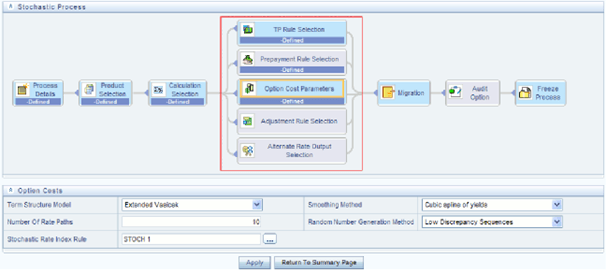

  6. Rule Selection Blocks:
    Figure 31-14 Stochastic Process - Rule Selection
    This screen allows you to select he Rule for the Stochastic Process.
    1. Select the assumption rules corresponding to each calculation element. The blocks shaded blue are mandatory and the blocks shaded grey are optional.
      The standard assumption rules are included in this step. Notice the Stochastic Process Flow has one additional Parameter Block, Option Cost Parameters:
      • Select a Term Structure Model
      • Select the Number of Rate Paths
      • Select the Smoothing Method
      • Select the Random Number Generation Method
      • Select a Stochastic Rate Indexing Rule
    2. Select Apply.

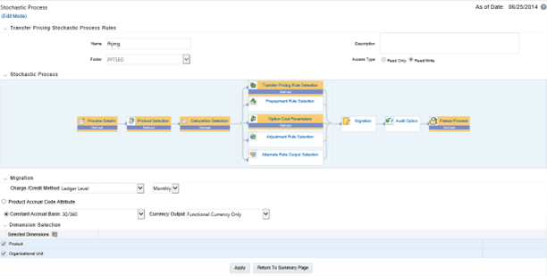

  7. Select Migration Parameters:
    Figure 31-15 Stochastic Process - Migration Parameters
    This screen allows you to select the Migration Parameters for the Stochastic Process.
    1. Select the Migration Charge/Credit Method. Choose either Account Level or Ledger Level.
    2. Choose between Monthly and Daily charge/Credit Accrual. The default selection is Monthly. If Daily is selected, a holiday calendar is also required to determine the number of days to accrue. For example, on weekdays (Monday - Thursday), 1 day of accrual will be posted and on weekends (Friday), 3 days of accrual will be posted at Friday's rate. When additional holidays are encountered on any other day of the week, similar logic is applied to extend the number of accrual days accordingly.
      The Accrual Type selection is only available for Account Level migration when the "Daily" accrual option is also selected on the Calculation Selection page.
    3. If the Ledger Level Charge / Credit method is selected, then also specify the Accrual Basis source as either the Product dimension attribute or constant value.
    4. Select the Currency Output option. Choose either Functional Currency Only or Entered and Functional Currency.
    5. Select the Migration Dimensions.
      On selecting the Dimension Selection button (see above), Oracle Funds Transfer Pricing provides you with a Shuttle Control component to select the dimensions for the migration process. The two areas of the Shuttle Control are Available Dimensions and Selected Dimensions. You can move dimensions from Available Dimensions into Selected Dimensions and vice versa by using the Move, Move All, Remove, and Remove All buttons.
    6. Select Apply.

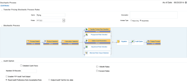

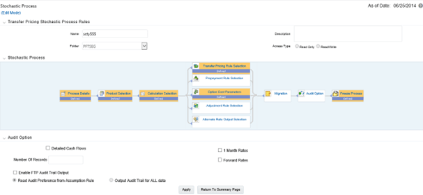

  8. Select Audit Options:
    Figure 31-16 Stochastic Process - Audit Options
    This screen allows you to select the Audit Options for the Stochastic Process.
    1. Select the Detailed Cash Flows option to output cash flow details for instrument records. This option is used for audit purposes when users want to validate the cash flows being generated by the cash flow engine for certain types of instruments.
    2. Select the Number of Records to include in detail cash flows. This input is constrained by the FTP Application Preference setting and controlled by the Administrator. The selection of a large number of instrument records to include in detail cash flow output can result in a very time-consuming process. Within Transfer Pricing, the maximum value for the Number of Records input is 10,000.
    3. Select additional parameters for detailed cash flows. The default values for the number of records is “Total Number” and “First n Rows”. It is also possible to specify the number of records per Product ID and Random selection as opposed to the First n.
    4. Select 1 Month Rates and Forward Rates options to output rate details which can be accessed by the Business Intelligence applications for reporting.
    5. Select Enable FTP Audit Trail Output to generate the audit data at the time of processing. You can select the relevant option for generating audit data for the entire data or read the audit preference from the assumption rule.
    6. Select Apply.

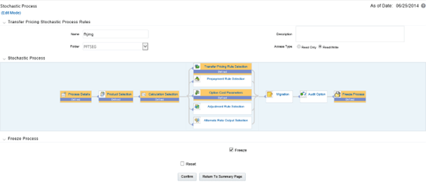

  9. Freeze Process:
    Figure 31-17 Stochastic Process - Freeze Process
    This screen allows you to Freeze the Stochastic Process with the selected parameters.
    1. Select Freeze to save the process.
    2. Select Reset to erase all selections made previously within the Process Definition Flow.
  10. Select Confirm.
