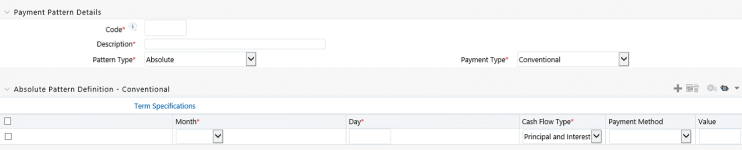

Figure 19-2 Absolute Payment Patterns
To define absolute payment pattern, do the following:
  1. In the Payment Patterns page, select Pattern Type as Absolute.
  2. Select the Payment Type from the drop-down list: Conventional, Level Principal, or Non-Amortizing. The Payment Type determines the type of information required to successfully define the Payment Phase.
  3. Define the Payment Phases. A Payment Phase is a set of payment characteristics that defines the timeline of the instrument's amortization.
    1. Define the following parameters:
      • Month: This drop-down list allows you to select the month of the payment phase being defined.
      • Day: Used to specify the day of the month the payment is due.
