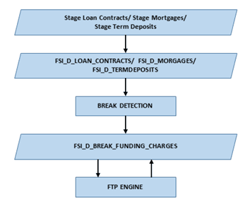

The following data flow illustrates how Break Identification processing works in the context of the overall staging and instrument table design:
Figure 11-33 Break Identification Process Flow
This data flow illustrates how Break Identification processing works in the context of the overall staging and instrument table design.

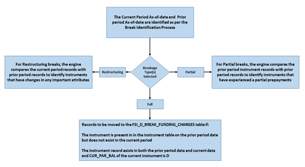

The following figure shows the overview of the Break Identification process:
Figure 11-34 Overview of Break Identification Process
This illustration depicts the overview of Break Identification Process.
