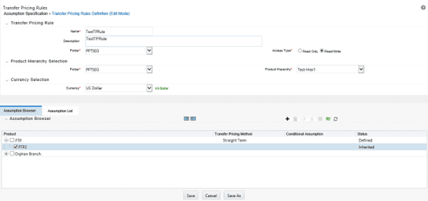

Figure 21-2 Transfer Pricing Rule Definition (Edit Mode)
This screen allows you to modify a selected Transfer Pricing Rule.

To define the assumptions with the default currency:
  1. Navigate to the Assumption Browser page.
  2. Select a Product Hierarchy.
  3. Select a Currency.
    The list of currencies available for selection is managed within Rate Management and reflects the list of Active currencies.
  4. Expand the hierarchy and select one or more members (leaf values and/or node values) from the product hierarchy.
  5. Click the Add icon to begin mapping Transfer Pricing Methods to the list of selected product dimension members. The system displays a list of all the products (for which you can define assumptions) or currencies (that are active in the system).
  6. From the Transfer Pricing Method Selector page, select the appropriate data source: Account Tables or Ledger Table.
  7. Select the Transfer Pricing Method for the selected product member.
    The Transfer Pricing Methodologies available depend on the selected data source. See: Transfer Pricing Combinations.

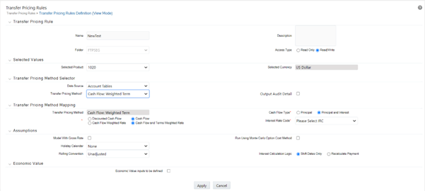

    Depending on the Transfer Pricing Method selected, certain required and optional parameter fields are displayed. You can update these fields as required. See Required Parameters for a Transfer Pricing Methodology. See also:
  8. Select Output Audit Trail to output the audit data at the time of processing.
  9. Specify the desired Option Cost Methodology. This option is available only when the data source is Account Tables. You can specify an Option Cost Methodology as follows:
    1. Select Run using Monte Carlo Option Cost Method. The Target Balance drop-down list is displayed.
    2. Select the required balance type. You can select any one of the following as the designated target balance for option cost calculations:
      • Par Balance
      • Book Balance
      • Market Value
        The Market_Value_c column should be populated if you make this selection, either by an Oracle ALM process or via direct load from an external source.
      For more information on Transfer Pricing Option Cost, See OFS Cash Flow Engine Reference Guide and Stochastic Transfer Pricing Process and Option Cost Parameters.
  10. Select the Holiday Calendar. The screen displays the Holiday Calendar inputs only for Cash Flow TP methods – Duration, Average Life, Weighted Term, Zero Discount Factors. The default assumption is None, meaning Holiday Calendar adjustments are turned off. If a Holiday Calendar is selected, Holiday Calendar adjustments will be enabled and the following two additional inputs will be required:
    • Rolling Convention
      • Following Business Day: The payment date is rolled to the next business day.
      • Modified following Business Day: The payment date is rolled to the next business day unless doing so would cause the payment to be in the next calendar month, in which case the payment date is rolled to the previous business day.
      • Previous Business Day: The payment date is rolled to the previous business day.
      • Modified previous Business Day: The payment date is rolled to the previous business day unless doing so would cause the payment to be in the previous calendar month, in which case the payment date is rolled to the next business day
    • Interest Calculation Logic
      • Shift Dates Only: If a future payment date (as computed by the Cash Flow Engine (CFE)) falls on a designated holiday (including weekends), the CFE will shift the payment date from the holiday as per the rolling convention. No changes will be made to the payment amount or accrual amount; this is simply shifting the date on which the cash flow will post. The subsequent payment dates resume according to the original schedule.
      • Recalculate Payment: This option includes the same Holiday Calendar definition as in the Shift Dates Only option, but it also takes one additional step to recalculate the interest payment amount (and interest accruals) based on the actual number of days in the (adjusted) payment period. The instrument records use the payment frequency (term and multiplier) and the Re-Price frequency (term and multiplier) in association with the Next/Last Payment Date and Next/Last Re-Pricing Date to determine when the cash flow will post. The CFE logic is enhanced to acknowledge holiday dates and re-compute the payment/interest amount given the change in days. In addition, the engine gets back on the scheduled track of payment events after a holiday event occurs in one (or many sequential) events.
      Holiday Calendar adjustments can also be applied to the Tractor TP Method. For this method, the Holiday Calendar assumptions are defined within the Behavior Pattern > Replicating Portfolio UI.
      Figure 21-3 Transfer Pricing Rule Definition (Edit Mode)
      This screen allows you to modify an existing Transfer Pricing Rule.
  11. Select Economic Value. This section displays the inputs required for calculating Economic Value. These assumptions are optional and the section appears only when the “Economic Value inputs to be defined” check box is selected.
    The following inputs are required for calculating Economic Value:
    • Cash Flow Interest Type: Select the interest rate to use for calculating the Interest Cash Flow. This interest amount, together with the principal amount will be discounted and used to arrive at the Economic Value of the instrument Record.
    • Interest Only: Select this option if you want to exclude the Principal Cash Flow from the Economic Value Calculation.
    • Exclude Accrued Interest: Select this option if you want to exclude accrued interest, (interest computed from last payment date to As-of-Date) from the Economic Value calculation. This will provide you with a clean price.
    • Interest Rate Code: Select the Interest Rate code to be used for discounting the cash flows.
    • Interest Rate Spread: Input any applicable spread to be added on top of the IRC rate.
    Economic value calculations are now supported for account rate tiers as well.
  12. Click Apply.
