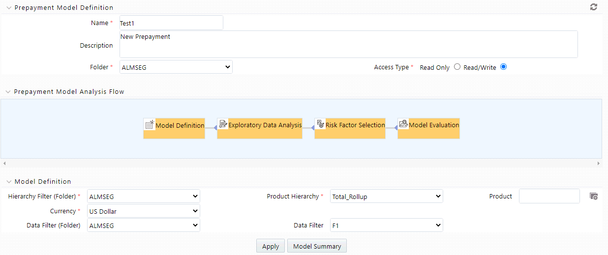

- Navigate to Prepayment Model Analysis window. Click Add .
The Definition window is displayed.
Figure 23-5 Prepayment Model Analysis
- Enter the following details.
Table 23-5 Form Fields to define a Model
Fields Description Name Enter the name of Prepayment Model Analysis rule Description Enter the description of Prepayment Model Analysis rule Folder Select the folder where you want to save Prepayment Model Analysis rule Access Type Select Access Type as Read-only or Read/Write. Hierarchy Filter (Folder) Select the folder of Hierarchy Filter. Product Hierarchy Select the Product Hierarchy. Product Based on the selected product hierarchy in model definition UI, Hierarchy Browser will expand the product hierarchy and you can select any parent/leaf node by clicking on the view button next to the product in the model definition screen. Currency Select the currency for the Prepayment Model Analysis rule. Default Currency option is also given, if you want to select the product irrespective of currency in which deal is booked. Data Filter (Folder) Select the folder name of data filter for Prepayment Model Analysis rule Data Filter Select the data filter to define the portfolio at more granular level than just, product and currency combination. - Click Apply to navigate to Exploratory Data Analysis window.

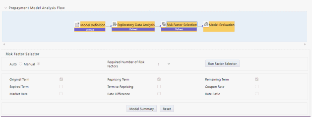

- Click Next. The Risk Factor Selection window is displayed. By
default, all the risk factors will be disabled.
Figure 23-7 Risk Factor Selection window
- You can change the risk factor selection mode to ‘Manual’ and all the risk factors
would be available for selection; maximum 3 factors can be selected after that all
the risk factors would be disabled again.
When you are in Auto Select Mode, System would perform required calculations, co-relation/collinearity analysis in the backend based on the required number of risk factors (Maximum 3), System would auto-select the best representative set of risk factors as per the input data.

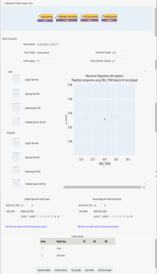

Figure 23-8 Model Evaluation
- Click Calculate to view all the evaluation parameters and quality plots.
- Click Re-Calculate if you are not satisfied with the model quality to
change the model parameters and revise the model definition. You can zoom the graph
to enhance visibility.
If you are changing parameters and generating different versions of the model, then you can see all the versions, generated with different set of model parameters in the Versions (Model) drop-down. If you have run “model evaluation’ only once, then this drop-down would not be available. As per the selected version, the Advanced model details window is also updated. The Model Details window helps you to evaluate the model fit. It has the following comparisons:
Predicted Values Vs Risk Factor 1,2,3, as per the number of risk factors considered for model building. This will dynamically adjust as per the number of risk factors selected.
Predicted Values Vs Test Sample.

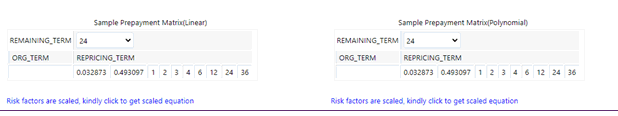

Sample prepayment matrix as per both the models (Linear and Polynomial).Figure 23-9 Sample prepayment matrix

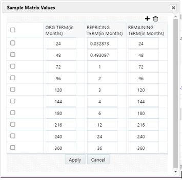

User would have option to redefine, values for sample matrix by clicking on “Re-define Sample” button. Below pop up would open up if user would like to re-define sample buckets. Again this pop up would dynamically adjust based on number of risk factors selected in the model.
- Click Model Summary to view Model Summary window, after saving all details.
- Click Re-Define Sample if you want to modify risk factor values
for sample matrix. This pop up would dynamically adjust to display 1,2 or 3
dimensions as per the chosen model.
Figure 23-10 Risk factor values
In case you want to update values on which sample matrix is generated, you can click on ‘Re-define Sample’. Below window would open up where you can update the risk factor values:
Add row using Add +. You can add multiple rows or delete multiple rows using buttons in panel 1. Default sample matrix is10*10, but once you re-define sample, matrix can be truncated to any dimensions.
The redefined matrix will be saved along with model.
Model summary parameters like R2, AIC and BIC.
Both (Linear/Polynomial) models are produced when the system compares model generated R2 against the R2 threshold defined by the user. The final option is given to you to choose any one of these models. Based on infrastructure availability and model complexity, user can choose any one of linear/polynomial model.
Click Save Model to save the model. Same model could be referred to populate prepayment rate matrix.
