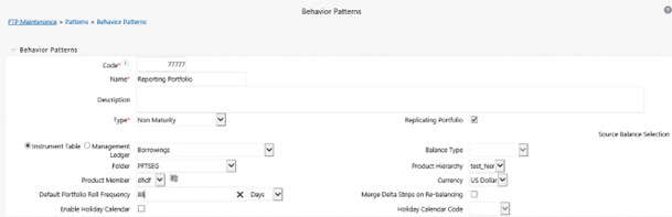

To define a non-maturity behavior pattern for Tractor TP method use, follow these steps:
- In the Behavior Pattern details page, select Non Maturity as the Behavior Pattern Type.
- Enter the following details:

View the Portfolio This option allows you to view the portfolio strips. This table describes various fields in the Behavior Pattern Details page. You can enter or select the relevant details to populate the screen to define the Non-maturity Behavior Patterns for the Tractor TP Method use.
- Make your required selections in the Source Balance Selection section.
- Click Add Core (one or more) to input the core amount, associated maturity term and strip frequency.
- To delete a row, select the check box corresponding to the row you want to remove and click Delete.
- Click Save.
The Behavior Pattern is saved and the Behavior Pattern summary page is displayed.
