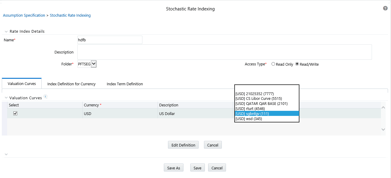

  3. Select Currency.
  4. Navigate to the Valuation Curve tab and select a Valuation Curve for the selected currency .
    Only a single Valuation Curve can be associated with a particular currency. For example, if the Valuation Curve for US Dollars is US Treasury Curve, all US Dollar indexes will be associated with the US Treasury curve.
    Select a risk-free interest rate structure. Not all the Interest Rate Codes in the application will have the characteristics of a risk-free rate curve, but the application will not prevent you from selecting any curve as the Valuation Curve.
  5. Select Apply.

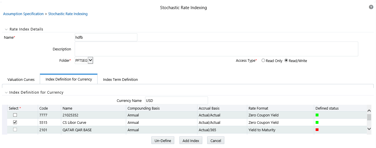

  6. Navigate to the Index Definition for Currency tab and select the Index using Add Index.

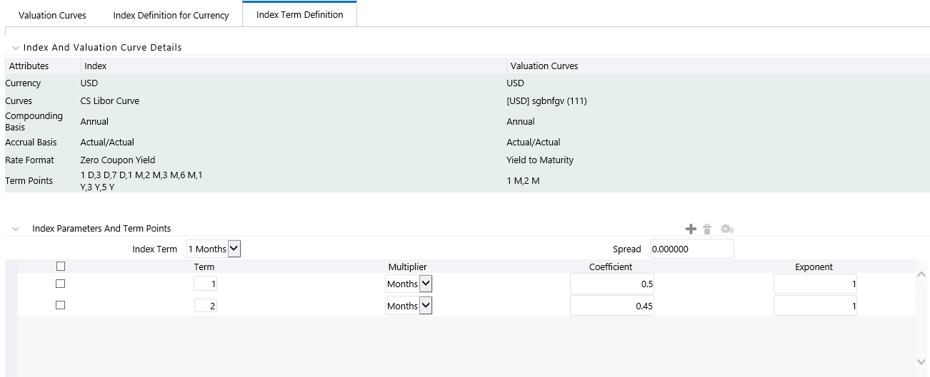

  7. Navigate to the Index Term Definition tab. The attributes of both the valuation curve and the selected IRC, are listed in Table 1. This information can be used as a reference to define the terms.
  8. Add Index Term Definitions. The Add Index Term Definition Page is displayed. The general attributes of both the Valuation Curve and the selected IRC, are displayed. This information can be used as a reference when you define the terms.
    Each Index Term Point can be calculated from up to eight elements of the valuation curve. The valuation curve elements specified can be any term point on the yield curve, it is not restricted to the points displayed for the valuation curve.
    Figure 28-5 Stochastic Rate Indexing
  9. Select the Index Term.
    Not all IRCs have Term Points defined. To successfully define an Index, you must define at least one of its terms. Else define one, many, or all of the Index Terms. The selection of the Index Term is limited to the standard Term Points as defined in the IRC definition.
  10. Enter a Spread for the Index Terms, if required. A Spread is a constant percentage added to the rate produced as a result of the Monte Carlo calculations, multiplied with the defined coefficient, and raised to the power of the mentioned exponent.
  11. Enter the Valuation Curve Term Point and select the Multiplier.
  12. Enter a coefficient for the element.
  13. Enter an exponent for the element.
  14. Repeat the last four steps for a maximum of seven more elements for each term.

    During rule creation, on the Index Definition forCurrency tab, the undefined IRCs are displayed in the top half of the window and the defined IRCs are displayed in the bottom half of the window. After saving the rule and re-entering in Edit mode, you can see the status reflected for all defined (green) and undefined (red) IRCs in the top half of the window. To Edit any Rate Index relationships, select the appropriate IRC, and again select Add Index and proceed with any changes.
