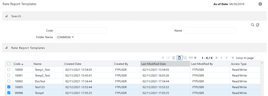

To delete an existing template, navigate to FTP Rate Card, and then select Rate Report Template. Select the check-box against the template that you want to delete. You can select more than one template for deletion.
Click the Delete icon in the summary screen. If there is no dependency, the selected templates are deleted with a confirmation message.
Figure 33-23 Deleting an Existing Rate Report Template
This Rate Report Template summary screen allows you to select an existing Rate Report Template and delete it.

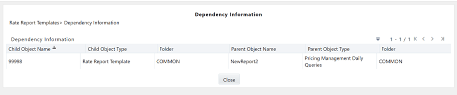

If template is currently is used in any of the rate card reports, it displays in following dependency information:
Figure 33-24 Deleting an Existing Rate Report Template – Dependency Information
This screen displays the dependencies (if there are any) for the Rate Report Template that you want to delete.
