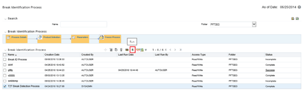

  1. Navigate to the Break Identification Process summary page.
    Figure 32-5 Break Identification Process summary page
    This is the Break Identification Process summary page.
  2. Select a Process that you want to execute or Run.
    The status column indicates whether a process can be Run. There are three possible status conditions:
    • Complete: Indicates the process is fully defined and ready to be Run.
    • Incomplete: Indicates the process is partially defined and cannot be Run.
    • View Log: Indicates the process has already been Run and also indicates a process can be re-Run. In this case, View Log is a hyperlink that allows you to navigate to the Log Viewer page where you can review any processing errors or alerts related to this process.
    Figure 32-6 Break Identification Processes View
    This screen displays the Break Identification Process view.

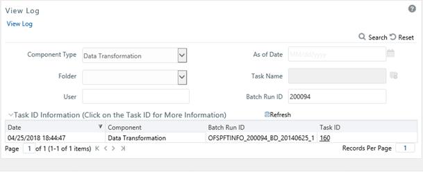

  3. After executing the preceding process, select the View Log hyperlink.
    Figure 32-7 View Log
    This screen displays the process that has already been Run and also indicates a process that can be re-Run. In this case, View Log is a hyperlink that allows you to navigate to the Log Viewer page where you can review any processing errors or alerts related to this process.
  4. Select the Task ID (also known as the Unique System Identifier) to view a report for any processing errors.
    If significant processing errors exist, you should re-Run your process.
    The Break Identification process is complete.
