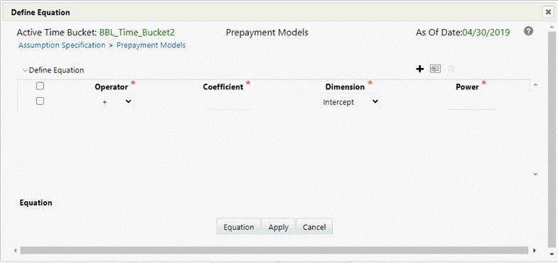

When you select External Model, Define Equation button will get activated to use external prepayment model. This is useful, when you want to do prepayment modelling outside OFSAA and use the model equation to calculate prepayment rates.
- Define the Dimensions and click Define Equation.
Figure 23-3 Equation
Figure 23-4 External Model
- Define the Equation.
For Example:
Equation becomes:
2 + 1.5 * original Term ^ 2 + 3 * Rate Diff ^ 2
Before defining equation, you must select dimensions and accordingly dimensions drop-down will display values along with Intercept. For example, if you have already chosen Original term and Rate Difference as dimensions, then Dimension drop-down list would displays the following three values:
• Intercept
• Original Term
• Rate Difference
Following mathematical operators are available: +, -, /and *. After defining all coefficients, Power, operators , click Equation to get the model equation. A confirmation message is displayed. Click Ok to use the same for prepayment rate calculations.
You can add new row for each term using Add +. Multiple rows can be added using Add Multiple Rows
- Click Apply on Define Equation window. Click Cancel to navigate back to Prepayment Matrix Screen window.
