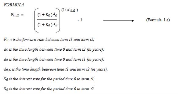

33.5.1 Implied Forward Rate Calculation
An Implied Forward is that rate of interest that is predicted to be the spot rate in the future.
Figure 33-8 Implied Forward Rate Calculation Formula
This illustration shows the formula to calculate the Implied Forward Rate.

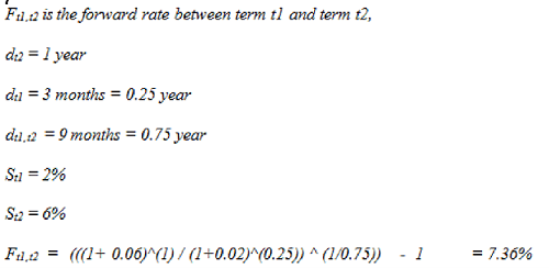

If 1 year TP Rate is 6.00% and 3 month TP Rate is 2.00% we can calculate the 3 months forward implied 9-month rate as follows:
Figure 33-9 3-month Forward Implied 9-month Rate Calculation Formula
This illustration shows the formula to calculate 3-month Forward Implied 9-month Rate Calculation.
Therefore, the market is implying that in 3 months, 9 month TP Rate will be 7.36%.

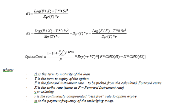

Rate Lock Option Cost Calculation: The Rate Lock Option Cost calculation uses a standard Black European swap pricing formula. This calculation is triggered by a Standard FTP Process and can be performed for both fixed-rate and adjustable-rate instruments. The following conditions must hold true for instrument records in the FSI_D_LOAN_COMMITMENTS table:
commit_start_date <= as_of_date
origination_date > as_of_date
Figure 33-10 Black Formula for calculating Rate Lock Option Cost
This illustration shows the formula to calculate Black Formula for calculating Rate Lock Option Cost.
Calculate Rate Lock Option Cost for a Rate Lock arrangement with the following details:
Table 33-2 Example: Option Cost Calculation
Loan Face value - ORG_BOOK_BAL 10,000,000
Tenor of Loan - ORG_TERM & ORG_TERM_MULT 5 Years
Locked TP Rate - TRANSFER_RATE 8.20%
Rate Lock Commitment period - COMMIT_TERM & COMMIT_TERM_MULT 90 days
Loan Payment frequency - PMT_FREQ 6 Months
Volatility 20%
Risk-free rate to Option Expiry 4%
Table 33-3 Required Inputs
Term to maturity of the loan t1 5 years
Term to the expiry of the rate lock option T 0.2465753 years
Strike rate - Locked TP Rate (Forward TP Rate as on Loan Origination) X 8.20%
Volatility
Details for Volatility - From the historical volatility curve that is loaded in Rate Management by the user, pick Volatility% with
EFFECTIVE DATE = COMMIT_START_DATE and LOOKUP TENOR = Tenor of the Loan. In Release 6.0, 2 Dimensional Volatility curve was introduced with Contract term and Expiry term as the 2 dimensions. v 20%
Payment frequency of the loan m 6 months
Continuously Compounded TP rate to option expiry r 4.08% (See the calculation (1) below)
Implied Forward TP rate F 8.20% (See calculation (2) below)
