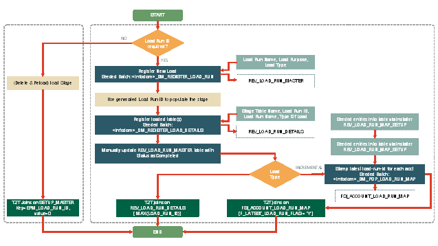

The following process flow diagram illustrates the Load Run ID for the T2T process.
Figure J-1 Load Run ID for T2T Process Flow
This diagram illustrates the process flow of Load Run ID process for T2Ts.
