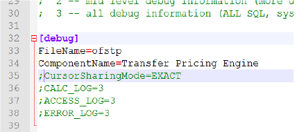

These are not hardcoded in the engine. You must provided the right values. The Engine does not validate these values. By default, cursor sharing mode is disabled in the ofstp.ini file which is present in $FIC_DB_HOME/conf folder:
When enabled, the Funds Transfer Pricing engine will read the CursorSharingMode parameter andset CURSOR_SHARE at the database session-level accordingly. The FTP Engine will execute the following statement if a value is given for CursorSharingMode.
ALTER SESSION SET CURSOR_SHARING = <Input Value in upper case>
<Input Values> can be: EXACT, FORCE, SIMILAR
To enable this, remove the semicolon in the ofstp.inifile as shown :
Figure G-14 Remove ofsfp.in
Remove ofsfp.in
