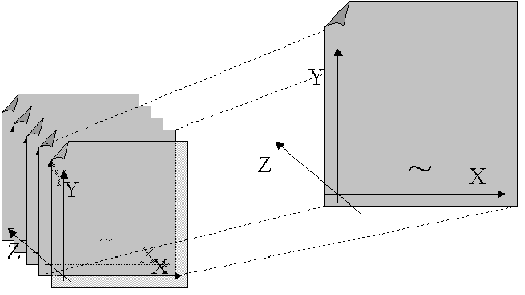

The following diagram illustrates a three-driver prepayment model:
Figure 11-14 Three-Driver Prepayment Model
This illustration depicts a three-driver prepayment model.
The ~ signifies a point on the X-Y-Z plane. In this example, it is on the second node of the Z-plane. The Z -plane behaves like layers.
Oracle Funds Transfer Pricing allows you to build Prepayment Models using the Prepayment Model Rule. The Prepayment Model Rule can then be referenced by a Prepayment Rule.
