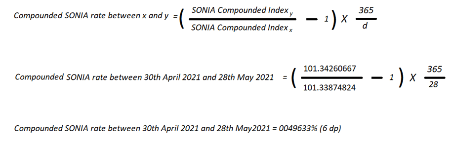

Where:
- x = 30th April 2021
- y = 28th May 2021
- d = 28
Figure 11-6 Compounded SONIA rate
