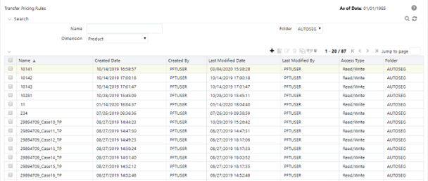

To search the Rules:
- From the LHS menu, select Funds Transfer Pricing, select
FTP Assumption Specification, and then select
Transfer Pricing Rules to display the Transfer Pricing
Rules Summary page.
Figure 13-1 Transfer Pricing Rules Summary page
- Search for the Rule, as follows:
- Select the folder in which the Rule is stored.
- (Optional) Enter the name of the Rule.
- Click Search.
Only Rules that match the search criteria are displayed.
