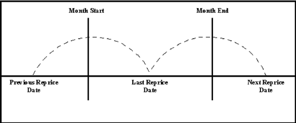

The following diagram depicts a typical Mid-Period Repricing situation where the instrument reprices during the current processing month.
Figure 11-8 Mid-Period Repricing
If an instrument reprices during the current processing month, then there are multiple repricing periods spanning the current month. In this example, there are two repricing periods in the current processing month and the computed last repricing date > beginning of processing month. Consequently, the repricing dates need to be rolled back by the repricing frequency until the Prior Last Repricing Date (Prior LRD) <= Beginning of Month and the Mid-Period Repricing Computation process should be executed as follows:

- If the computed last repricing date > beginning of processing month, roll back to prior repricing date.
Since the Last Repricing Date is greater than the Beginning of the Processing month, the Roll Back is done as follows:
Computed Next Reprice Date is reset to Last Reprice Date
Computed Last Repricing Date is reset to Last Repricing Date - Reprice Frequency (Prior LRD)
