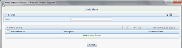

The Undo window is displayed.
Search for the TP Process rule that you want to undo. The rule is displayed in the Undo Rules list. Select a rule and click Undo.
Figure 31-20 Undo Rules
