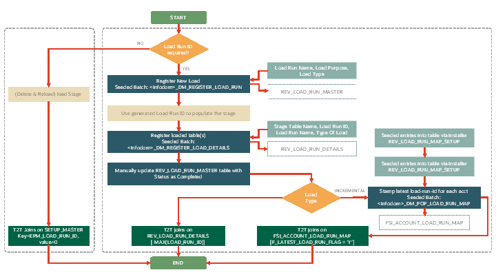

The following process flow diagram illustrates the Load Run ID for the T2T process.
Figure 11-1 Load Run ID for T2T Process Flow
