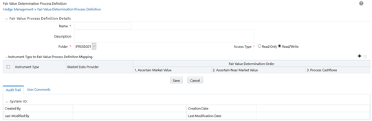

Creating a Fair Value Definition
- In the Fair Value Process Definitions form, click
Add to open the Fair Value Determination
Process Definition window.
Figure 6-2 The Fair Value Determination Process Definition pane
- Populate the Fair Value Process Definition Details pane
as tabulated.
Table 6-2 The Fair Value Process Definition Details Table
Field Name Description Name Enter a name for the definition. Description Enter a description. Folder Select the Folder from the drop-down list. Access Type Select either Read Only or Read/Write. - In the Instrument Type to Fair Value Process Definition

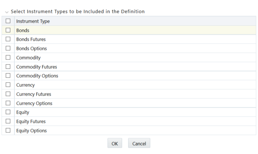

Mapping form, click Add to open the
Select Instrument Types to be included in the
Definition window.
Figure 6-3 The Select Instrument Types to be included in the Definition Window
- Select the required Instrument Types by selecting the checkboxes adjacent to the Instrument Type names and click OK. The selected Instrument Types are displayed under the Instrument Type to Fair Value Process Definition Mapping form. This pane displays those processes which are already checked. These processes can be modified according to the requirement. However, for instruments such as Loans and Advances, only a particular process is allowed to be selected as these may not be traded in the market. Click Delete to remove the Instrument types by selecting the checkbox adjacent to the Instrument type. To remove all the Instrument types present in the Instrument Type to Fair Value Process Definition Mapping form, select the checkbox present in the column header in the Instrument Type to Fair Value Process Definition Mapping form.
