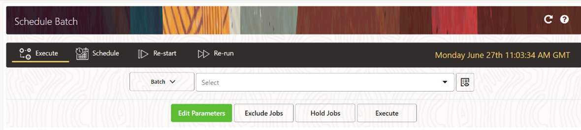

The Execute Batch option allows you to run a batch instantaneously. To execute a Batch/Batch Group, perform the following steps:
  1. Click Schedule Batch from the Header panel.
    The Schedule Page is displayed.
  2. Select Batch or Bath Group to execute, from the drop-down list.
  3. Select the Batch /Batch Group Name from the Select Name drop down menu. For example, AMLDataLoad.
  4. Click Execute.
    The Execution Schedule Page is displayed.
    Figure 18-6 Execution Schedule Page
  5. If you want to exclude/include some tasks, click Exclude Tasks.
  6. If you want to hold/release some tasks, click Hold Tasks.
  7. If you want to edit the dynamic parameters of the batch, click Edit Dynamic Parameters.
  8. Click Execute.
    The Batch is executed, and the associated unique execution ID is displayed.
